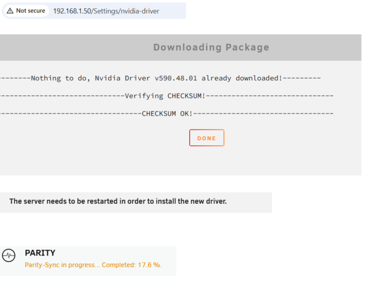

I installed the nvidia driver and it says it wants a reboot.

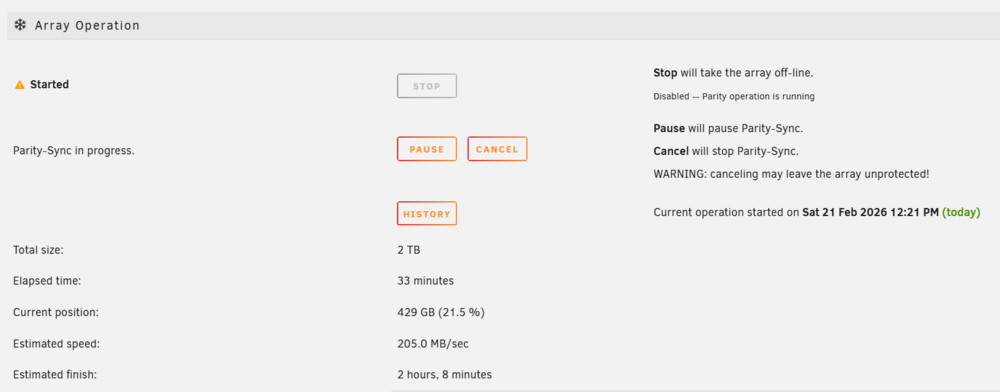

But the parity isn't finished. Will take and 2 hrs 20 min, (which ends up being 3 hours if it is like the last UNRAID box setup).
Q: Can I stop it ?
Looks like I have my answer.
is it safest to just do something while the parity runs ?
I was kinda surprised I was able to install the nvidia driver plugin while the parity check was running.
Can you install Dockers while the parity check is running ?
Unless you installed the parity check tuning and configured it to allow resuming operations before you started the sync, if you reboot you'll have to start over.
Yes, can do everything, just anything touching the array will be slow.
