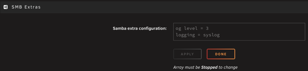

Looks like you have an invalid entry in smb-extra file.
Ok.
What is the smb-extra file?
And how do I fix this?
Settings - SMB - SMB Extras
Remove this:
og level = 3
logging = syslog

found this:
I now remember why I enter this. Was for some old printer to scan to SMB share on my unraid.
