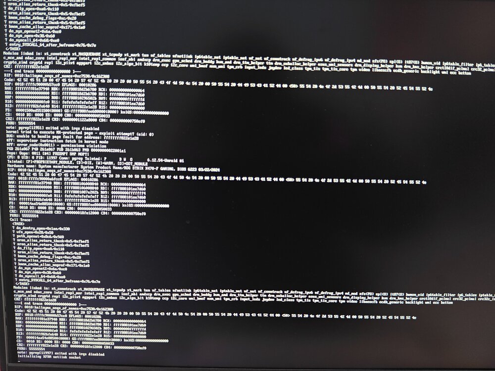

What do you mean? Where does the boot stop? You can post a photo.
It stuck on this screen

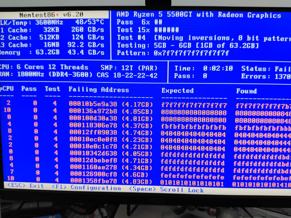

No I didn't, Should do memtest after a unclean shutdown?
Start by runing memtest
Memtest found a lot error,My memory run on 3600Mhz, Maybe I should trun off XMP ?
Definitely, since Ryzen with overclocked RAM is known to corrupt data, but you should still run a long test after that.
Even 1 error is too many.
You must never attempt to run any computer unless memory is working perfectly. Everything goes through RAM. The OS and other executable code, your DATA. EVERYTHING!. The CPU can't do anything with anything until it is loaded into RAM.
I trun off XMP, Run a full memtest and it passed, Then the OS boot up,Thanks to you all.
