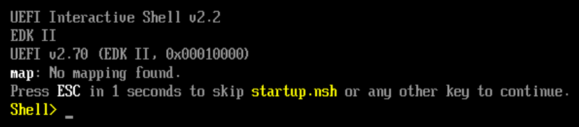

Home Assistant VM boots to UEFI shell
Since last week my HA VM has been acting up. Suddenly crashing, but seemed to get back to its feet when started again. Unfortunately right now it can't even seem to figure out what feet are.
Reading topics about the issue, the initial instability might have something to do with memory. Increased the memory and to be sure increased disk capacity as well. No go.

Have copied the XML to a new VM and pointed it to the existing image. Same message, no difference.
And as a bonus, now the new VM cannot be removed. It's stopped, select to remove VM... nothing.

Just found that changing the Primary vDisk Bus from VirtIO to SATA solves the issue.
Was is always SATA and magically changed to VirtIO due to an update?
Or has something in the image changed to that it now requires SATA?
I have no way of telling, but right now I'm just happy Home Assistant is running again 😀
