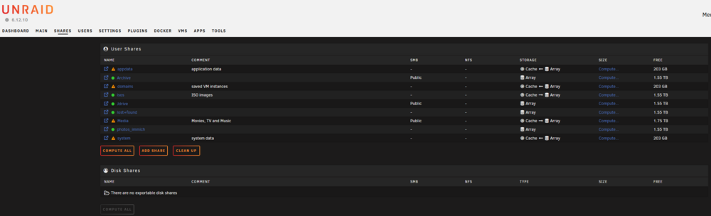

Immich started having issues and then my Shares disappeared.
I ran xfs repair and it enabled the array to work again but only a few shares returned but I cannot see data within them. Still says theres data within it though. Just cant view it.
Not sure what the next steps could be.

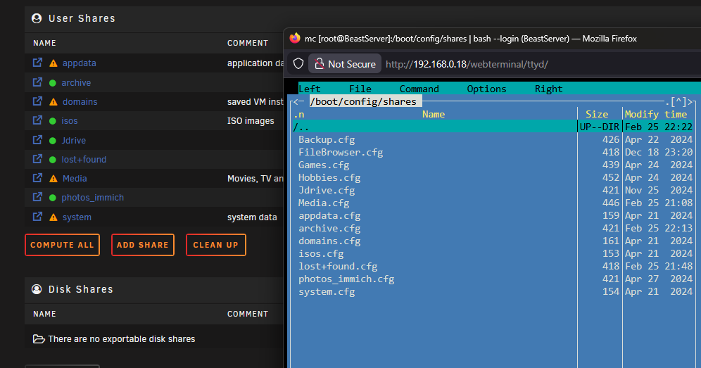

I found via MC the old config files for the shares - not sure if this helps. I suspect all my data is in the lost+found file.

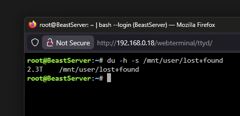

Another command that will show how much data is lost+found
du -h -s /mnt/user/lost+found

So I'm guessing the Share config files being in the Share folder and not showing up doesn't mean much when it comes to the data right?
I have backups but its more the time spent setting it all up that I'm lamenting.
Those are just the settings from the webUI for each share. If the data isn't there the shares don't exist.

What do you get from command line with this?
Not at home to enter it yet. I'll post that before I do anything else - thanks for all the help thus far.
Edited by Angelis
Looks like thats all the data
Most of it. Diagnostics showed these shares with data on disk1:
A-----e                           shareUseCache="no"      # Share exists on disk1
isos                              shareUseCache="yes"     # Share exists on disk1
J----e                            shareUseCache="no"      # Share exists on disk1
l--------d                        shareUseCache="no"      # Share exists on disk1
M---a                             shareUseCache="yes"     # Share exists on cache, disk1
p-----------h                     shareUseCache="no"      # Share exists on disk1
When open those shares - I dont see any data.
I suppose all I can do is start sorting though the lost and found and put them in the right places. Any advice?
Also while Im here. Are the appdata, domains,system and Media supposed to be "unprotected"? I have only 1 cache drive, so Ive read thats the reason. Just confirming.
