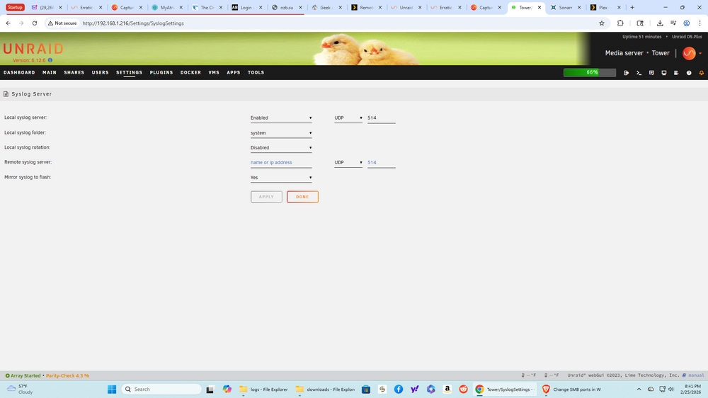

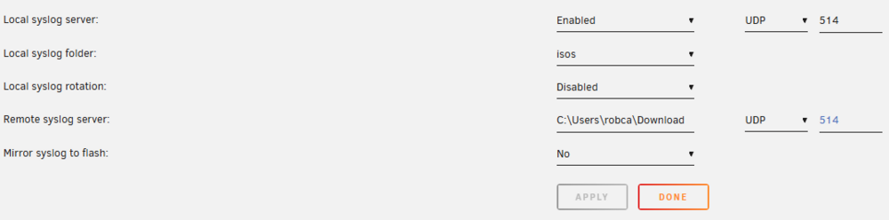

So far it has not failed again. I want to change the syslog to remote server.
Will this setup work?
Just put localhost and then it will store the logs in your isos share the way you have it.
Lots of things would have to be setup elsewhere to make it log to another computer on your network.
