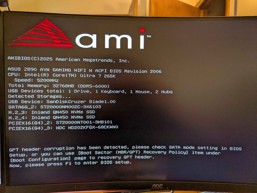

  • Connected a keyboard and monitor and saw the error shown at the bottom of this post from my BIOS before even booting into unraid (Note this is not my screenshot, it's one I found online but this is the same error I'm getting)
    • "GPT header corruption has been detected, please check SATA mode setting in BIOS Setup, or you can use [Boot Sector (MBR/GPT) Recovery Policy] item under [Boot Configuration] page to recovery GPT header."

Yes sorry I wasn't super clear but that's not my screenshot, it's just one I found online that had the same error because I couldn't reboot my server at the time last night. Here's a screenshot from my system:
I've got two PCIE cards that give me more sata ports. I built in a Jonsbo N5 which has 12 bays so I needed more sata ports to connect them all even though I'm not using all of them yet.
I disconnected one at a time in an attempt to isolate which one might be the problem. However none of my drives, when removed individually, got rid of the error. Should I try removing all of them at once? Thanks!
