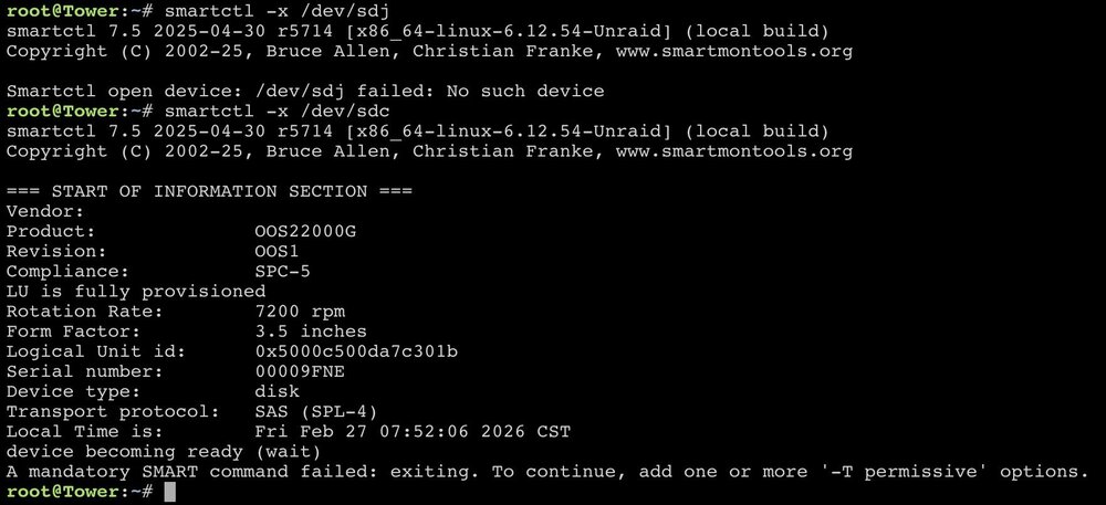

Post the output from smartctl -x /dev/sdj
Smartctl open device: /dev/sdj failed: No such device
I currently only have one of the faulted drives connected as I was trying it in different bays right before posting. It was one that shows size zero and looks like it’s displayed as sdc. I tried the command with that one and got the screenshot.
Not even smartctl is working, which suggests a disk issue, or a problem with the controller it's connected to.
It's not probable but not impossible that 4 disks died in 6 months. Crazy though. One of the other drives shows partial smart errorrs. When I try to format it in a pool I think it's giving errors. Or something preventing formatting in the pool. That one prompts this on smartctl
