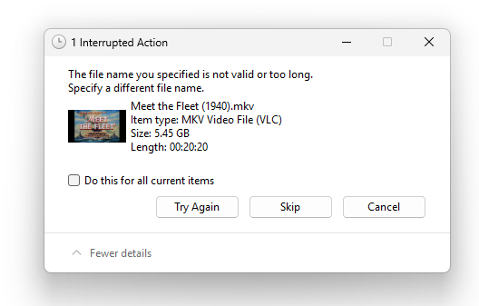

Pulled the 24TB drive from the SATA bus, installed it back into the D2-320. Plugged the D2-320 into my air-gapped computer's (no inet connection) 3.2 USB. Tried copying files, and...,
got the old "The file name you specified is not valid or too long. Specify a different file name.". WTH??? I've seen this error in decades past, but this is not that issue.
The filename is NOT too long. Just for grins I named a couple of the thousands of files to "fred" or "bob" .mkv and tried copying - same message.

Went back to my master files on the main computer, and copied via USB 3.2 to the D2-310 with the same 24TB HD. Plugged the D2-320 into the air-gapped computer... and all THE SAME FILES copy fine. And still play fine in VLC.

I also confirmed that BOTH the DAS's I have exhibit the same problem.
It appears that for whatever reason... the TerraMaster DAS's (D2-310 and D2-320) don't play well as UD in UNRAID 7.01.
