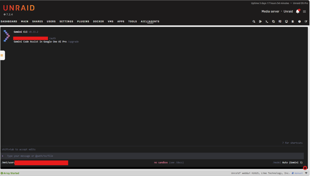

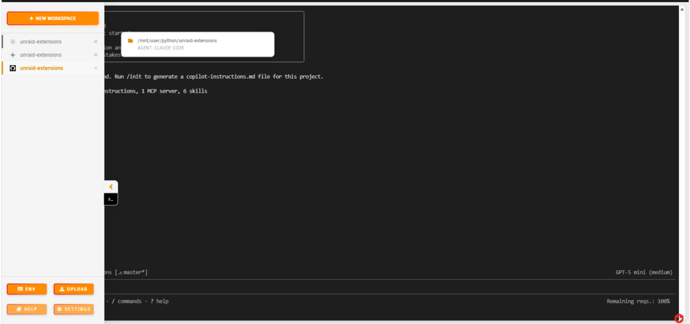

Work space manager pops out, create new, manage ENV variables, upload screenshots/files, instantly switch between workspaces and agents:

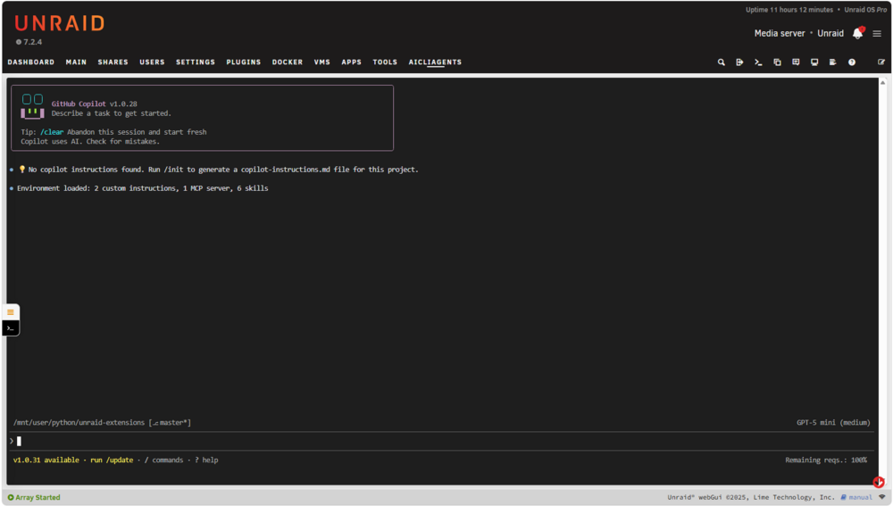

Example view of agent running:
Jump into a home & work space mapped temp shell while into your flow:

Thanks for the plugin, can you update it so that the left side isn't buried under the unraid menu? i have the left side menu configured and the start of the prompt is underneath the left side menu
can you send a screen shot please? I'm not familiar with what the left side menu is, i'll go investigate though as curious now!
UPDATE: I had a quick check of settings, and a google search, it appears you're using a custom theme - is that right? If not, can you point me to where the setting is please?
This is how it renders on mine with the regular menu:
The tab on the left to open the drawer can be moved up and down.
Edited by johner
