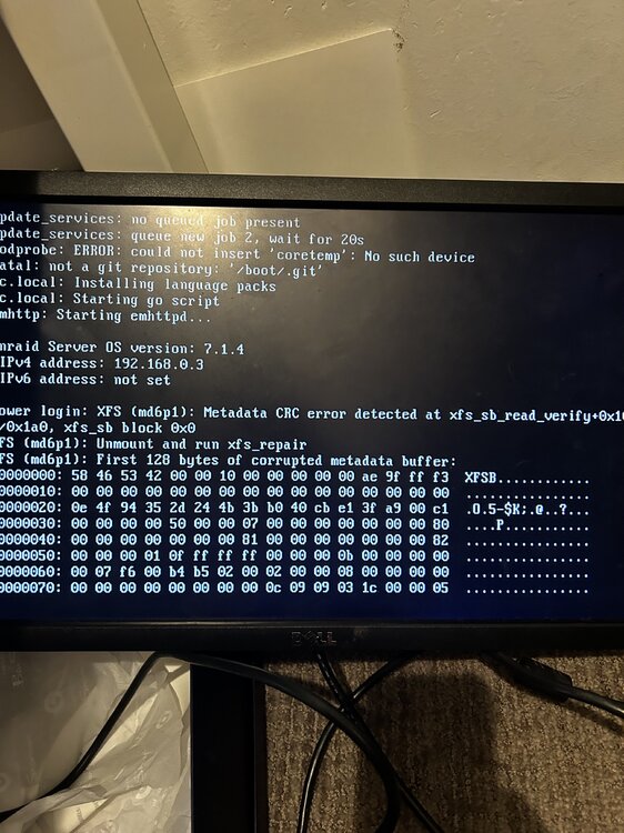

metadata crc error on log in
I had a drive start to fail and had to reboot before I could swap in a new drive. I'm not sure if I attempted xfs_repair correctly.

Screenshots from the webUI are much preferred over photos.
Since you provided a command line photo from your xfs_repair attempt you probably did it wrong. More than one way to get the command line wrong for that. You should use the webUI to check filesystem, it will use the correct command.
Do you know the exact command you used?

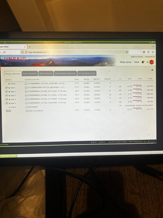

Disabled/emulated disk6 is unmountable.

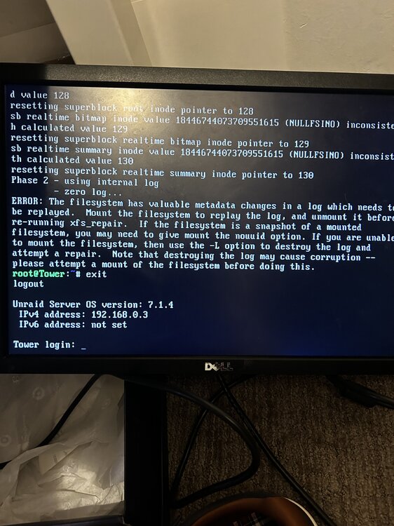

These are the steps I took.
Start the array in Maintenance Mode.
Run the following command: xfs_repair -v /dev/md6p1
Now it gives me the error
Next step was xfs_repair -L /dev/md6p1
That seemed to fix the issue.
Now the only issue I have is that I'm not able to access the GUI when Unraid finishes booting. I can choose Unraid OS GUI at startup, but this doesn't start the Docker
That was the correct xfs_repair command.

Im at a complete losshere. I recreated the flash with the creator and replaced my /config but still no boot into Unraid OS. It boots into Unraid OS GUI mode, and I'm able to rebuild data, but no web access.
