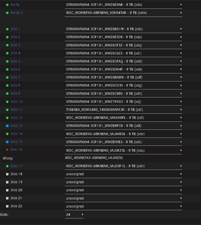

But as I was doing this...drive 16 suddenly reported to the a wrong drive. And it was stating which drive was the correct one (serial number), but that IS the drive assigned in that slot.
What is going on ? Now the array wont start in normal or maintenance mode!
Disk16 is showing as wrong because it was recorded with a 4TB partition.

15 minutes ago, Einar Eliassen said:
/dev/sdu7 7814039104 15627846207 7813807104 3.6T Linux RAID
This is likely the data partition, meaning it's only using half the disk. Post the output from
blkid /dev/sdu7
blkid /dev/sdu7
/dev/sdu7: UUID="e45da7a6-4b00-4e35-9ff3-53af5d1a590a" TYPE="crypto_LUKS" PARTUUID="b3419e82-856d-4bd7-8f33-4a7c3b80ab74"
It has the expected LUKS signature, and that partition matches exactly what Unraid was detecting.
You can try this (assuming parity is still valid).
-Tools -> New Config -> Preserve current assignments: All -> Apply
-Check all assignments and assign any missing disk(s) if needed, including the new disks you want to rebuild
-IMPORTANT - Check both "parity is already valid" and "maintenance mode" and start the array (note that the GUI will still show that data on parity disk(s) will be overwritten, this is normal as it doesn't account for the checkbox, but it won't be as long as it's checked)
-Stop array
-Unassign disk13 and disk15
-Start array (in normal mode now), and post new diagnostics
P.S.Disk16 will be detected as 4TB again, but you can fix that later.

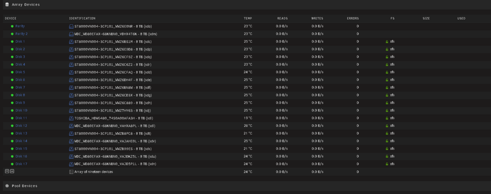

After just starting the array again the first time it all looks good ? All disks are green.
Do I still need to remove and assign the drives again ?

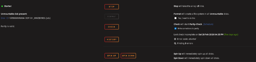

Disk 15 is now showing as unmountable: wrong or no filesystem
If I click to format this, it doesnt seem this will rebuild it ?
I have started a check on the drive....looks like its gonna take many hours.
