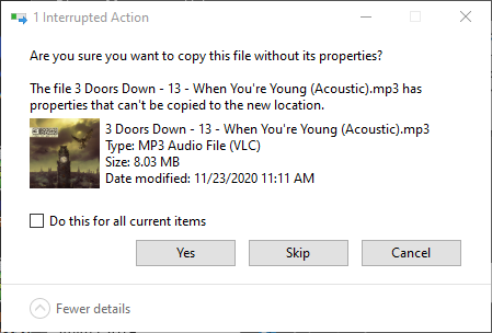

I turned off "enhanced macos interoperability". Now I get a different error warning that some properties won't be copied.

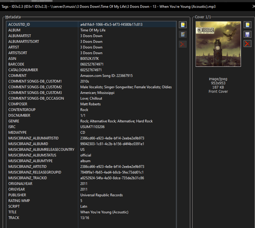

These are the properties of that particular file:

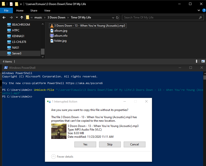

That should not be about the ID3 tags, try this on one of the files and then see if it copies without the warning
In PowerShell type
Unblock-File "C:\Path\To\File.mp3"
I applied the code to the source file. Same problem.
