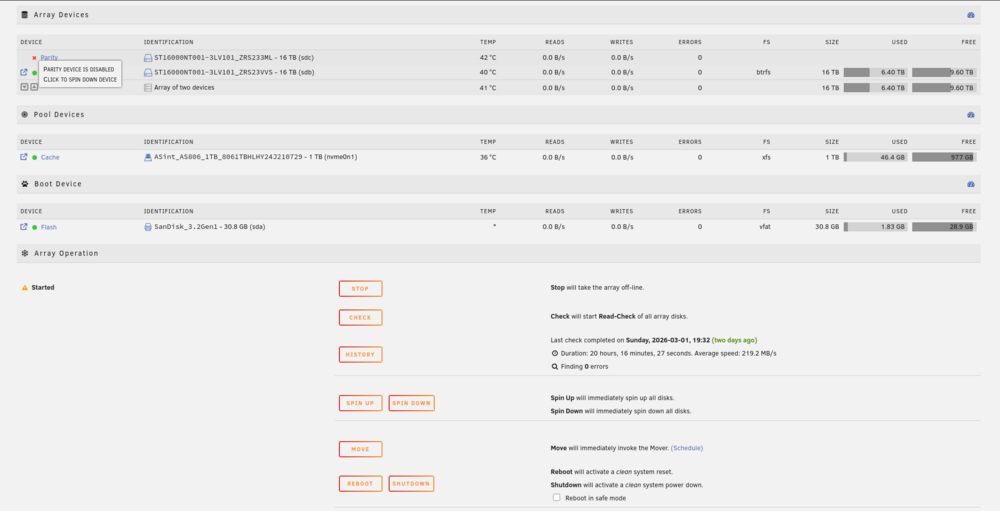

Less than a year ago I set up UNRAID on an AOOSTAR R1 with two spanking new Seagate IronWolf Pro 16 TB. All to run mainly Plex and store my media. The main drive is sdb and the parity drive is sdc. Everything has been going swimmingly for months until I discovered this weekend that my parity device has been disabled and there an X right next to it (see attached screenshot). If I mouse over the X it says "Parity device is disabled. Click to spin down device". That is the current status.

Why wont the device go online, what might be wrong and how do I fix it? I've attached a screenshot and the diagnostics logs.

Any idea why it was disabled?
It was already disabled at boot, so we can't see what happened, but SMART looks fine, so most likely a power connection issue.
It may be worth checking/replacing the cables before re-enabling to rule that out.
The device is syncing as I write but it looks fine so far. Thanks for your support. :)
