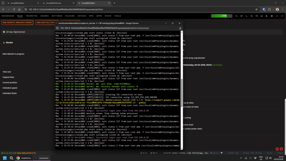

The data rebuild was started yesterday at about 9am and was reaching completion this evening, but the progress stalled at 95.5% It has been there for the last 3 hours. There is no disk activity anymore - emby is now not being used by anyone, so no reads or writes.
The log shows that ;
Mar 5 21:46:14 UnraidNAS kernel: md: sync done. time=132208sec
Mar 5 21:46:14 UnraidNAS kernel: md: recovery thread: exit status: 0
Which I Googled to mean that the reconstruct had completed with no errors, but the main page and dashboard still say 95.5%, meaning I am stuck - I would rather not "cancel" the rebuild, I cannot stop the array as there is a Parity Operation running, I did try to pause the rebuild, but that did nothing. The only thing I can think to do is shut the thing server down by the power button and hope that it does not demand a rebuild on restart, though it would obviously want to do a parity check.
Would anyone have any suggestions? Have I misunderstood the 2 log entires that I think indicate successful completion?
I'm running a diagnostics right now - it is taking a loooooong time on the shares, but I will post it when (if?) it completes, and also a screenshot of the log and the apparent progress of the rebuild. Sorry the screen grab is so blurred, not sure why.
