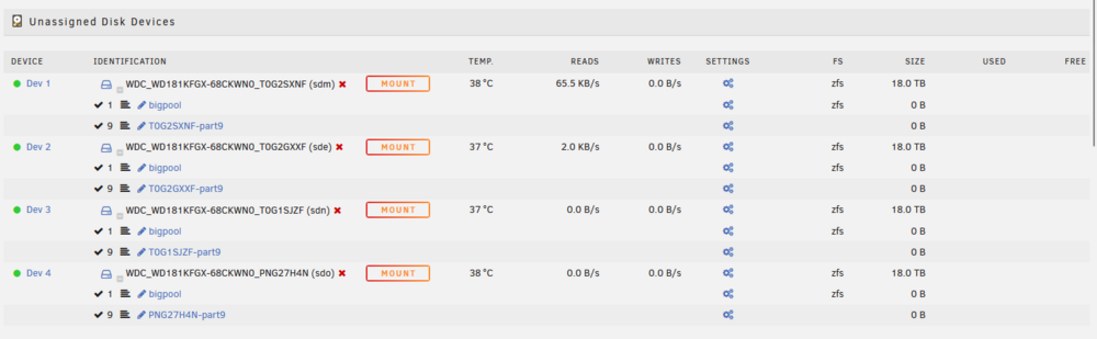

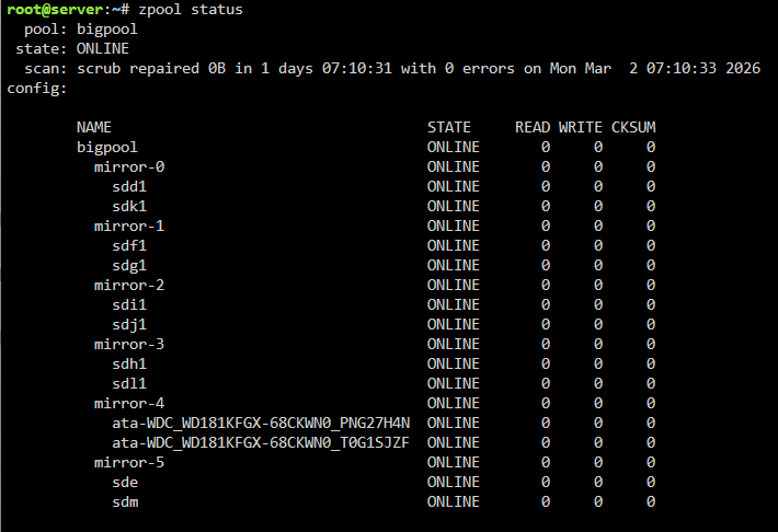

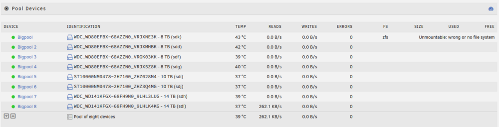

I'm running 7.2.4. Have this issue where I've got 12 drives in a zpool, but only 8 of them are showing up in the Pool Devices section. The other 4 show as unassigned. They're definitely all in the same zpool though. Is there any way to rectify this?
The other issue is this "Unmountable: wrong or no file system" error.
I did manually create this zpool via the command line a while back, due to the limitations of the webUIs ability to handle different sized drives at the time. Each of the mirror sets in the pool are using identical drives.

Try this:
Pool must be export first zpool export bigpool
Now reimport the poo using the GUI with all devices:
on main click on the first device for that pool and then "remove pool"
back on main, create a new pool with the same name and 2 slots
assign the pool device(s), leave the filesystem set to auto
start the array to import the pool, if it fails post new diags.
