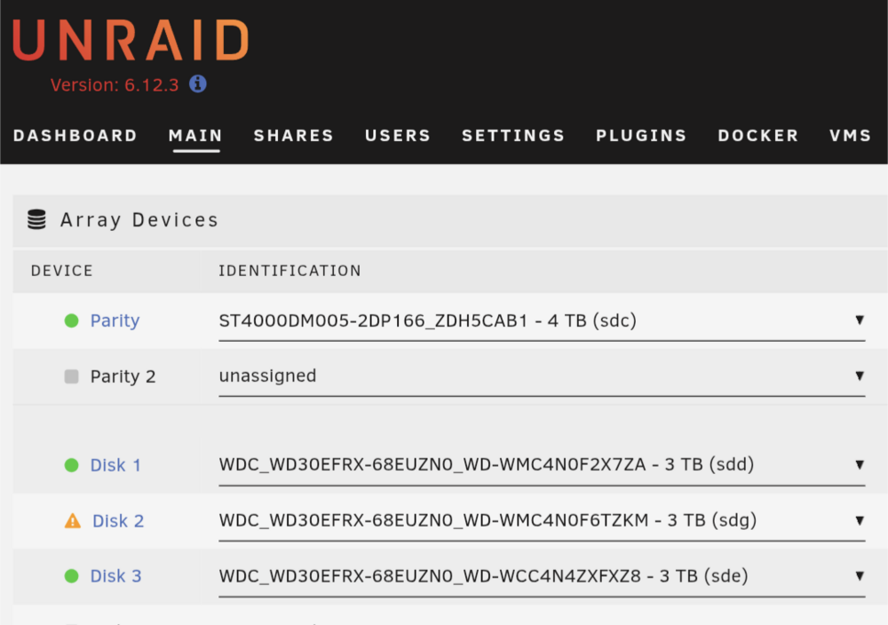

Hello. I am unable to start my array... it looks like one of my drives is dead, and the other went missing at some point recently and unraid doesn't like it. After shutting down the system and checking all of the cables and doing some swaps, I was able to get my disk 2 to show up again, and 4 still seems dead. It shows up in the device dropdown, but says "4.1GB" yes, GB, when it should say 3GB. My disk 2 reads "device is disabled, contents emulated"
I know it's likely that I will have to start over from scratch, but if there's any way to get this working so i can pull off my data?

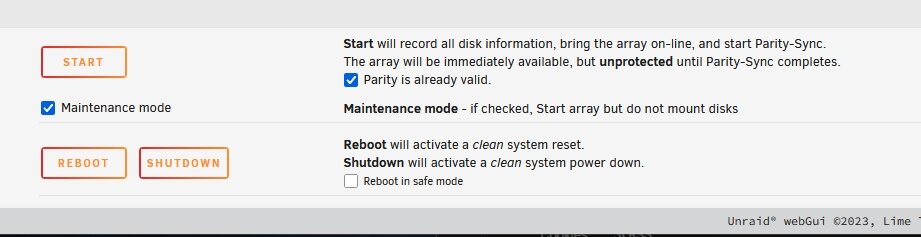

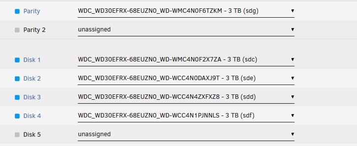

  1. Install new 3TB drive, then boot up.
  2. Tools - New Config - Retain All - Apply
  3. All assignments should be as before, except assign the new 3TB drive as disk4.
  4. VERY IMPORTANT! Check BOTH Parity Valid and Maintenance Mode boxes, then start the array. This will accept all drives as NEW just as they are assigned without changing them in any way.
  5. Stop the array, unassign disk4, start the array with nothing assigned as disk4. This will disable disk4 so it can be rebuilt. But...
  6. Before proceeding any further, post new diagnostics at this point so we can check that emulated disk4 is mountable.

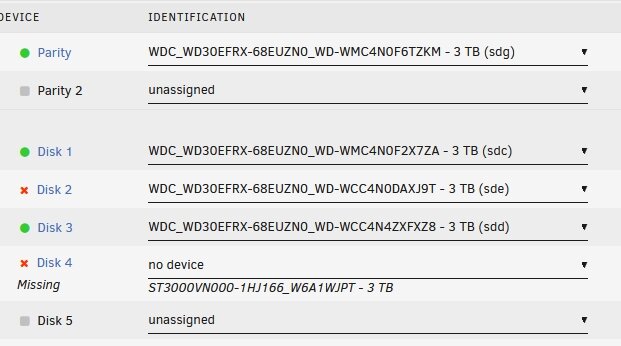

as an aside, I think this disk 2 has been disconnected for some time. I'm not seeing any files on it that have a datestamp of 30 days or newer. My best guess is that this drive was gone for awhile, and then disk 4 just died today/last night. After plugging disk4 in a standalone SATA to USB adapter not in my very loud basement, it's clear that there's some sort of physical damage to the platters.
That means parity may no longer be valid with it enabled, but check filesystem on the emulated disk 4 to see if it can be repaired.
No need to guess going forward.

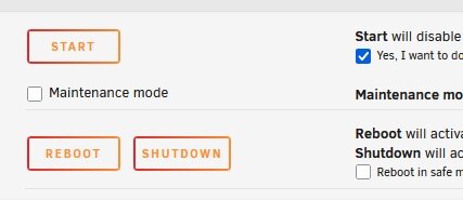

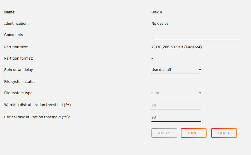

not yet... do i need to re-select the drive?
I'm in maintenance mode with no disk selected... there is no option to "Check filesystem status"

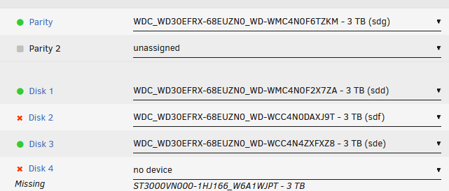

additionally,. it does not say or seem that disk4 is being emulated at all
We need to get it to check filesystem on the disk4 slot, not on the physical disk. It is emulated but unmountable currently. And it doesn't know what filesystem it should be so it doesn't give you the button to check.
Let's try it from the command line, still in Maintenance mode, with nothing assigned as disk4:
xfs_repair -v /dev/md4p1
Post the output

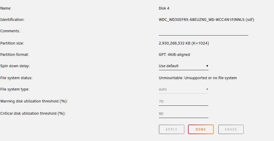

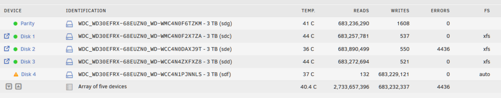

also: when following your instructions from last night, in step 5, when I restarted the array, it was not in maintenance mode as it did not say to do that. Not sure if this is a problem but I don't want to waste your time if we've already messed up
I should have explicitly said to start in Normal (not Maintenance) mode, so you did it right. It has to be in normal mode before it will attempt to mount any disks so we can see if it is unmountable.

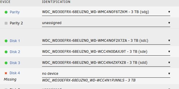

Since we already know the emulated disk is unmountable (Unraid couldn't mount it), we have to tell xfs_repair to proceed without the log, so do
xfs_repair -v -L /dev/md4p1
and post the output.
