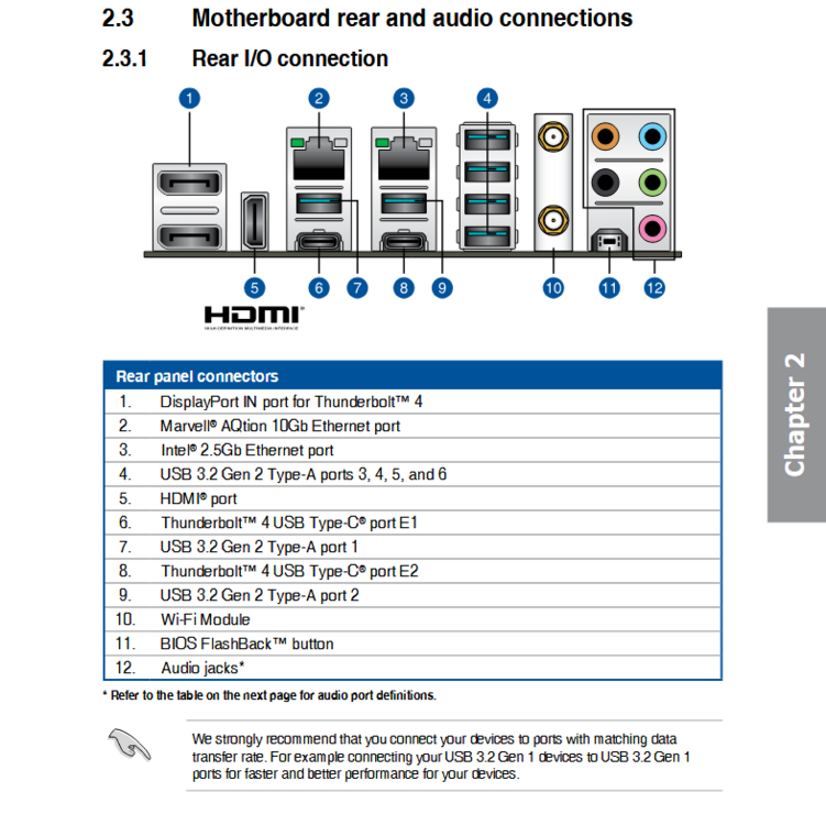

Yes, that's the drive, not sure why it's showing those speeds for these ports but It's definitely connected correctly.
See attached, drive is connected to port 8 (USB C TB4/USB4) and the Sandisk is connected to port 7 (slower USB A port)
Would there be a reason it only shows on boot and can't be unplugged and plugged back in? (drive does light up)
It's make it unusable at this point.
Try the other USB Type-C port, port 6.
Not sure, but Thunderbolt support in Linux can still be a little flaky, though it's currently not operating in true TB mode. Still could be related; my suggestion for that would be to try Unraid 7.3 when that is out, it will use a much newer kernel, which should have a considerable number of TB related improvements.
Attached now with it it in port 6 (had to reboot again for it to show)
Asus specs do say that it's USB4 compliant too, if that makes any difference.

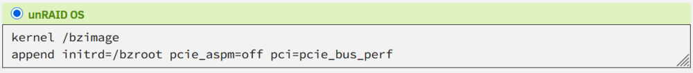

A few things you can try:
  1. Click on the flash drive, scroll down to the Syslinux configuration section, make sure Menu View is enabled, and add after /bzroot to the default boot option, the one in green:
pcie_aspm=off pci=pcie_bus_perf
It should be added to the same line as /bzroot, just leave a space between that and the kernel option, then please reboot and retest.

  1. I've attached what I now have in Flash section.
