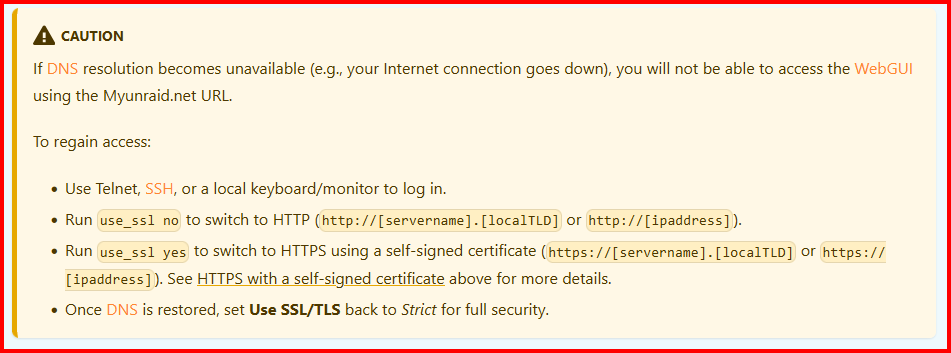

March 10Mar 10 Community Expert Solution https://docs.unraid.net/unraid-os/system-administration/secure-your-server/securing-your-connection/#https-with-myunraidnet-certificate-and-with-no-fallback-urlOPen up this link and find this.....

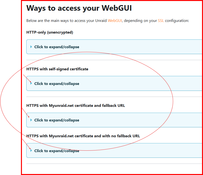

March 10Mar 10 Community Expert Look here:https://docs.unraid.net/unraid-os/system-administration/secure-your-server/securing-your-connection/#ways-to-access-your-webguiThen pick the one you want and click for instructions:
March 10Mar 10 Author Thanks after reading that link I figured out that on the device that I'm using to to connect to the unraid Web UI, I need to manually configure the DNS, so it's not using my routers DNS, which has Rebinding Prodection ENABLED and so doesn't allow redirected traffic to local addresses.I configured my PC to use google DNS instead and now the FQDN address is working. Thanks for your help everyone. I think this is completely resolved now.
