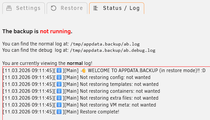

So before anything I did a backup with Appdata Backup, move anything from the cache to the array, and thought it was enough to restore the options and dockers.
So I replaced the drive to test it and it formatted it, but when I tried to run the appdata backup plugin, it didn't restore anything and gave me this error, no matter which backup file I choose.
