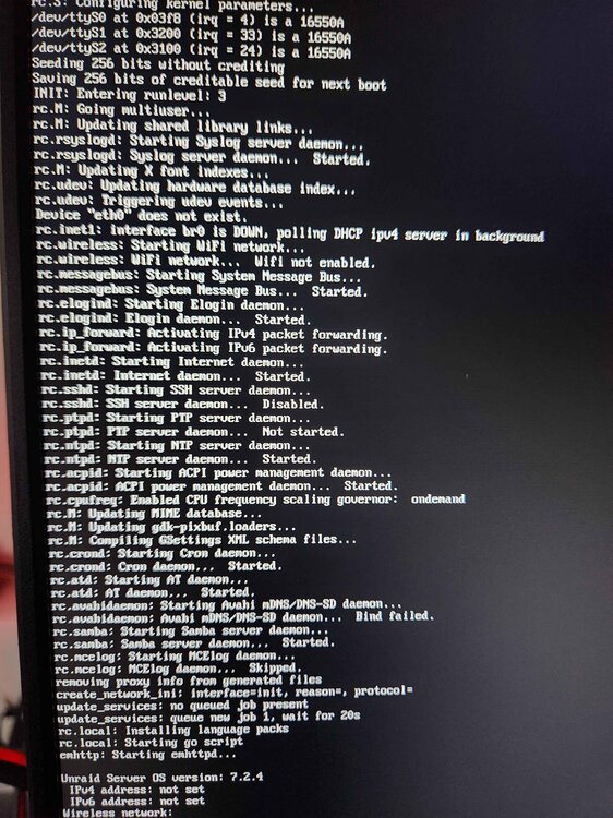

I started downloading plug-ins and the two plugins that I believe that could be causing my issue would be the Nvidia driver's plug-in and the rtl8125b PCI driver's plugin, soon after installing those two I tried to install Dockers and I was having trouble installing them due to a file layer issue I believe but I tried looking up a remedy and it told me to delete the docker directory then reboot the system, soon after I did that the system rebooted but I wasn't able to get into the web GUI and I lost all connection to the ipv4 and it gave me this error on my terminal when I ported into the main device does anybody have any suggestions or advice and what did just be easier for me to completely start over and transfer my key, please help what should I do mind you there's nothing on the server I'm starting fresh and very new to homelabing

Get the diagnostics, or if it's a new config, you can also start again.

Is it a paid license?
Whether paid or trial, your license .key file should be in config folder on flash.
Assuming there is nothing actually wrong with the flash drive, you just create a new install on that same flash drive, put your license .key file on it, and you won't need to transfer license.
If you do want to use a different flash drive, you still need to put your existing license .key file on it so you can do a license transfer.
thank you this actually helped
also wiping my cashe drive too because no matter how many times i restart it keeps my olld appdata and system files
