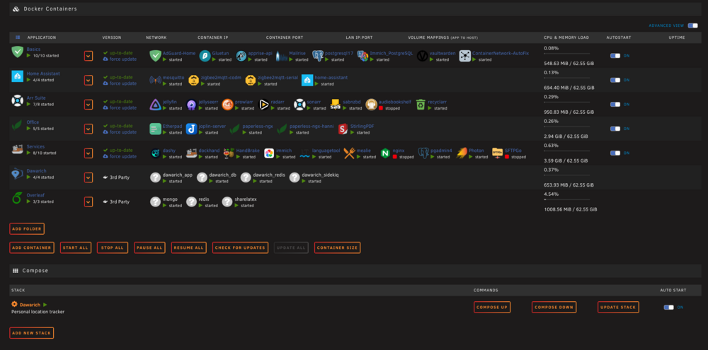

After a reboot of my server a couple of arbitrary Docker containers did not start automatically:
I tried to start them from the GUI and got a "Error code 403". So I delete the containers in question and tried to recreate them. But this time I got a "docker: Error response from daemon: Address already in use.". I also tried to stop and start the Docker daemon again with and without a reboot. No luck.
The problem is, that I am very sure, that the port is not in use (lsof -i :8088 reports nothing in case of nginx configured on that port)?! And it worked before the reboot without change. What am I doing wrong? Help would be very much appreciated....
