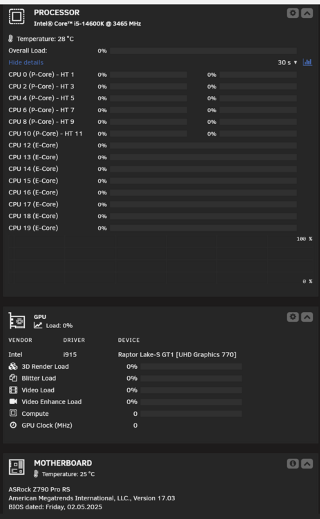

CPU load on dashboad not showing
Hi all,
i am quite new to Unraid, figured out quite a lot so far and really enjoying it!

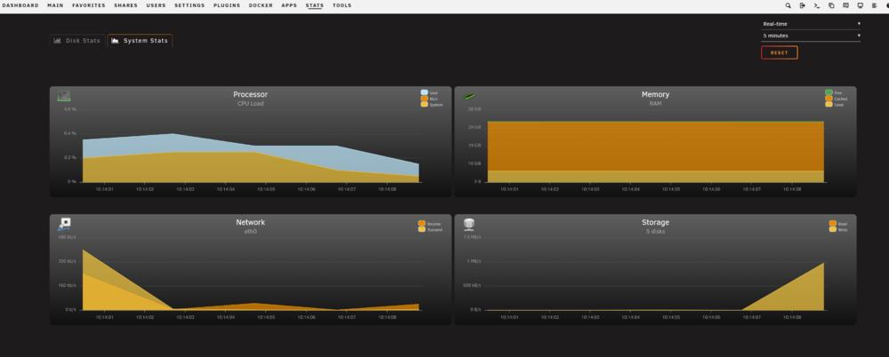

One problem i still have is that my CPU load is not showing correctly on my dashboard (see picture below). The GPU is actually working, since when i use it to transcode videos it starts showing some loads. I have installed Dynamix System Information, Intel GPU TOP, and Dynamix System Statistics. I already tried installing the plugin freshly, but it didnt help. Also in the Stats screen from Dynamix System Statistics plugin the CPU load shows correct (see second picture). My motherboard is also nearly up to date (only one newer version is available).
What can i do to fix this?
Many thanks in advance!
Try rebooting in safe mode, if it still doesn't work, post the diagnostics.
In safe mode it works, so its one of my plugins then?
