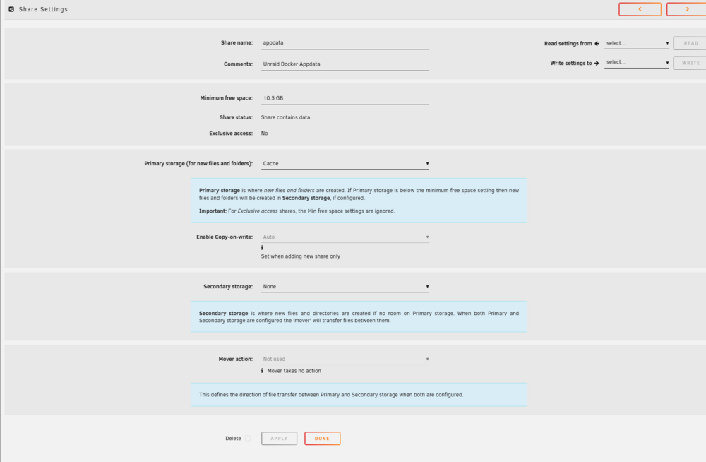

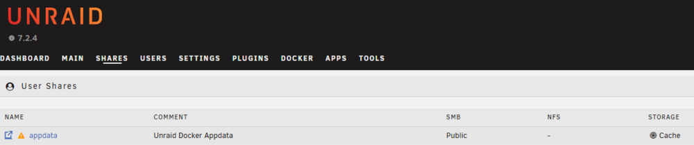

My appdata share is exclusively on a btfrs mirror of two enterprise-class SSDs - set up as per Unraid best practice. Mover doesn't touch my appdata share - ever. Yet I have been having the problem. So, it's not just about how our shares are set up. I've been running my Unraid server for 8 years and have run countless dockers over that time and never seen anything like this. You seem to be implying that those of us with this problem have our appdata share incorrectly set up. Not true in my case.

i have my entire appdata folder only on my cache drive not across multiple drives but i haven't had the issue in about 3 days since updating to 7.2.4
edit: before it was happening almost every night.
