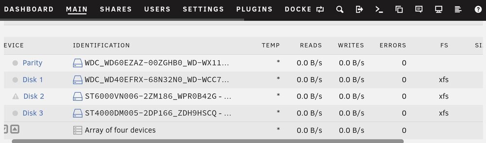

One of my HDD failed, and is missing after reboot. Purchased a new one, server restarted and swapped disk 2. I'm trying to rebuild according to parity drive.

1hour after it seems like nothing is happening.

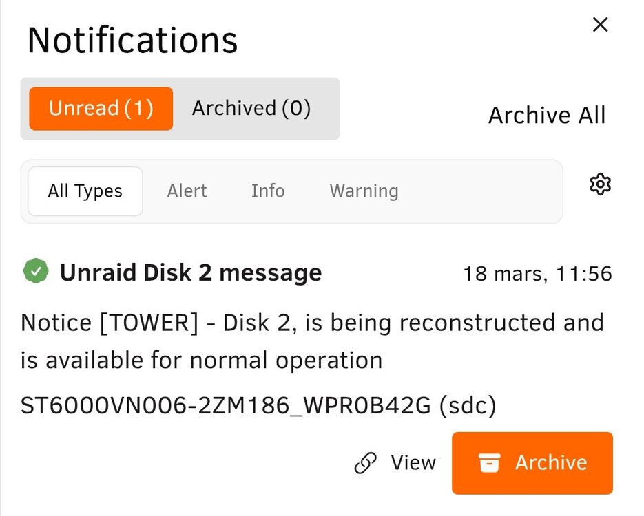

A notification told me it's being reconstructed
But there is no writes to disk, and no reads to others.

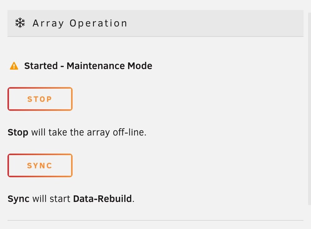

Should I click "sync" to start data rebuild ?

Have you pressed the Sync button to start the rebuild?

It would start automatically if you restart the array in Normal mode. In Maintenance mode you need to press the Sync button.

Alright, pressed the sync button then, instantly rebulding disk !
