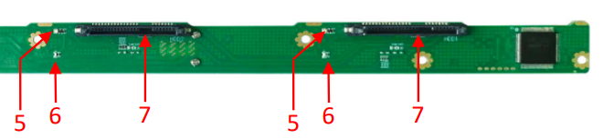

By observe, there are a chip on each backplane and it doesn't look like for enclosure management only, SAS signal may go through this chip.
