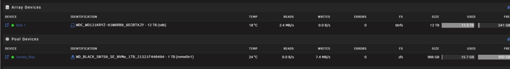

what cauese Mover to only copy at 1 -3mb/s from cache to a single drive array
right now i wanna try practicing zfs and the benefits.. on one of my unraid servers
when i set the mover to move docker vms from the nvme to the array .. i onlky getting from 1 to 3 megs per second
i have the mover tunning installed and set to reconstruct... i have the docker and vms managers turned off but for some reason i getting piss poor speed i should get like what 80 to 250mbs roughly
but to transfer 74gb its going to take forever...
and the single array drive is a WD 7200 drive ... so not sure what causes it this massivly slow

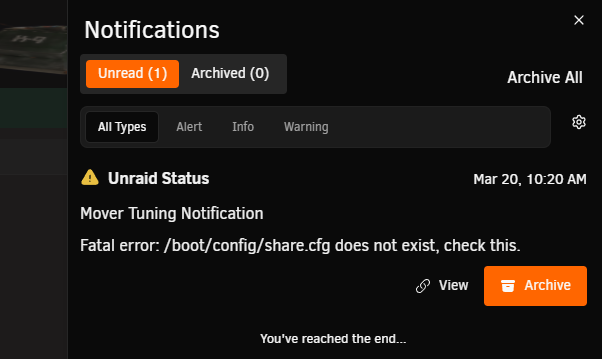

i looked at the nofications pop up on the screen and it shows share.cfg issue but i have shares is there a way to fix this and the other others or are the other errors due to the share.cfg issue
i re saved each share to update incase that fixes share.cfg
i then rebooted and re tried again still cant move
instant error as you see... so i not sure how i fix? or do you gotta reformat things?

i cant seem to fix the mover crashing though share.cfg what does it mean? and how do i create a share.cfg?
guess its a global setting i tried the google ai
but gotta reboot unraid cuz mover has locked things up as you cant run it with the array on
Just now, comet424 said:
@MowMdown oh ok ill give it a shot see what memtest shows up with
Your USB may not be writable and for some reason is missing the share.cfg file. Not sure what's up with that. Someone else may have to answer that.

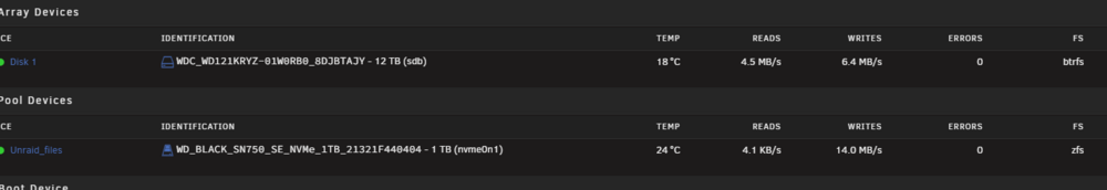

so i formated the cache drive to zfs
i set the shares to go from array to cache
and ran mover it instantly stopped.. wasnt working.. i ended up uninstalling cache mover, and cache tunning
and set the disk settings to reconstruction write
i i re pressed move button.. and seems to be moving back but it went from 1-3 mb/s to a 6-8... 3meg read on the array and a 6-11mb/s write on the nvme
didnt improve much... here i figured it would jumped to 100mbs as a secon... wonder what is causing the slowness the ram ran 3 memttests and passed each one no fault
so its going to take a way to copy back... i know the disk speed test... but ive never been able to test the cache drives
and running "top" in the command line the "wa" fluxuates from 0.0 to 0.5 not sure if those are the good readings for the copy wait or so what i watch a video about slow mover transfers
