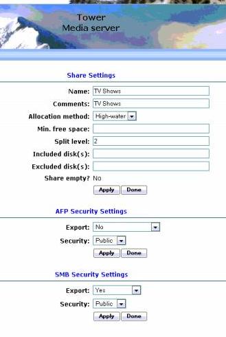

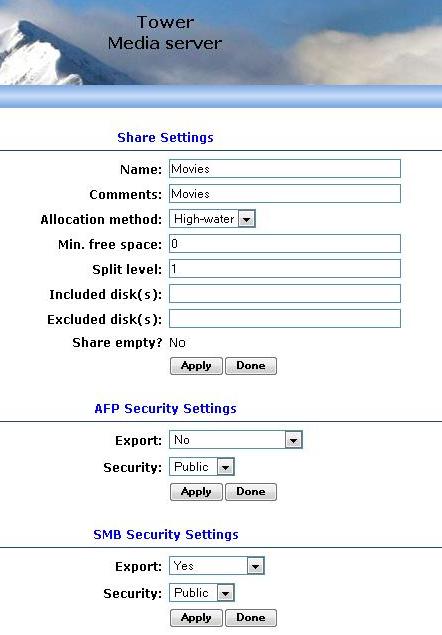

Any thoughts on the easiest way to move data from the two currently full drives to the new one after it's added to the array?  Can I just cut a few movies from the array and then add them back?  I"m using High Water so I would assume that since the new drive has the least amount of space, everything would be written to that drive.
I found the "Min free space" option, but that seems to be share specific and not disk specific so I don't think that will do what I want.
First create your user share on the new disk.
Then...I would probably do a old disk-->new disk copy<using the disk shares> (If I'm making big changes I like to copy instead of move-just in case ;)), then a delete off the old disk.
You'll want that "min free space" once you start using the user share.

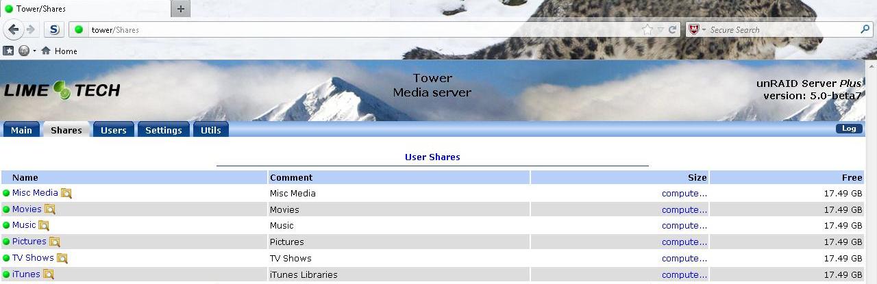

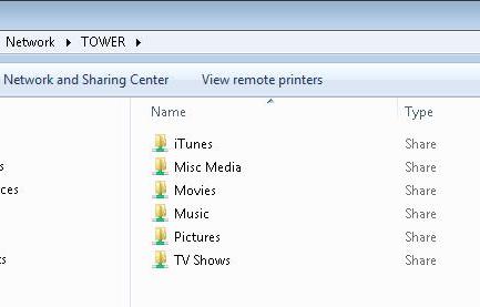

I assume you also have mapped the disk shares to windows explorer?
I just created a shortcut on my desktop and pointed it to \\tower and access it that way when I want to add a movie or TV Show.
Here are some pictures of my shares and settings.  I only included the TV Show and Movies shares because I don't use the others very often.
