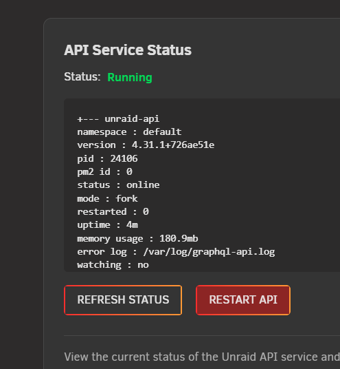

ok stopped array and ran unraid-api restart in terminal
seems to show online, but when i go into connect settings and press refresh, it still shows launching and still cannot generate new API key

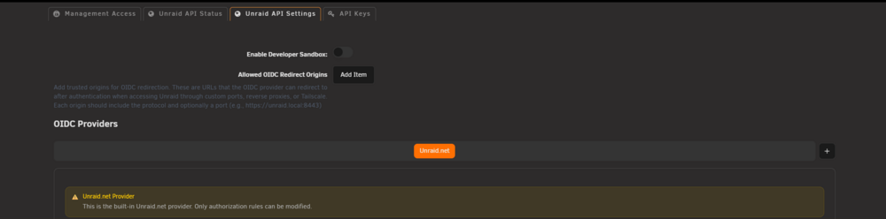

How do you sign in when you get this:

If you have to add your key at some point too, I had to, it will tell you how to do it. It's basically just clicking on the boxes that are hidden links.
How do you sign in when you have this:
Do you see the Connect icon? The orange ball, top-right of the GUI.
I would reboot the server.
If that doesn't allow the sign in button to appear, remove the unRAID Connect app, then reinstall it.
If the plugin is uninstalled, but the orange icon doesn't show, open a terminal window and copy/paste
unraid-api plugins install unraid-api-plugin-connect
Once that's done, refresh the GUI and you should now see the orange icon.
