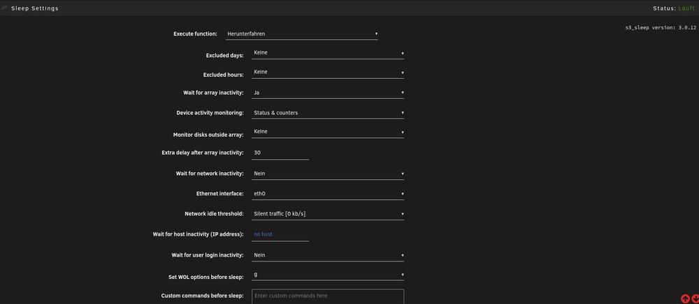

I'd like to use the Dynamix S3 plugin to boot my server via WOL (Magic Packet).
So far, I haven't been able to get it to work; the VPN is not active.
Neither from my Linux laptop (Zorin OS) using the command: wakeonlan macaddress, nor via the FritzBox by enabling WOL in the network settings.

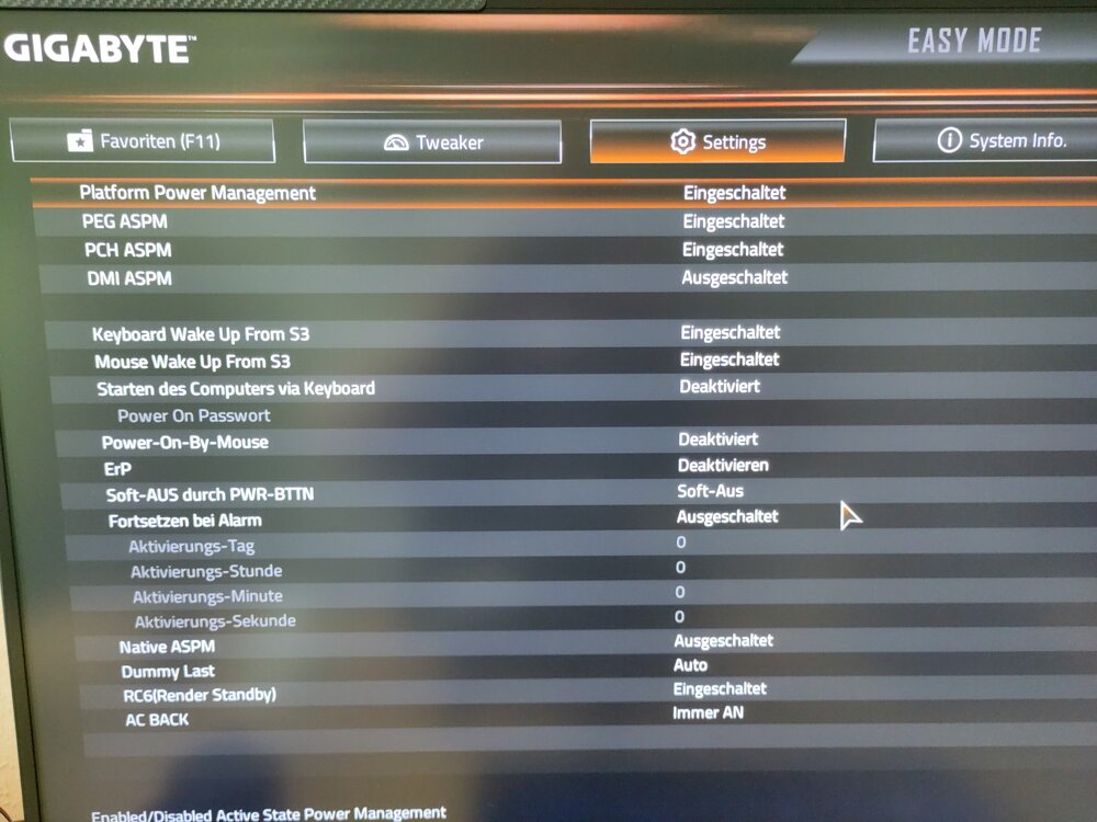

Here’s my setup:
Motherboard: GIGABYTE B760M DS3H DDR4
Unraid 7.2.4
s3_sleep version: 3.0.12
My UEFI settings are shown in the image…
My S3 Dynamix Sleep settings are also shown…
What am I missing… what else can I check?
