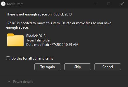

Started getting this when uploading any file size. minimum free space is set to 160Gb on both share and cashe. ive restarted both server and PC as well. i was able to upload over 80 gb of movies the other day and now its not. im using 12TB out of 30TB total so theres more then enough room.Any suggestions?

it also seems that it only part of the file that its having issues with. it starts to upload to the server then fails at roughly 24% some of the video and data makes it over but the rest of the file acts like it doesn't have enough room.
If you edited Minimum Free for cache or for that share, you might try restarting the array to see if it will apply the new settings.
According to the diags, floor for Media is 1GB
this was one of the first things i tried. i set both cash and share to twice the size.

This is when i upload from either my PC. i have a network share titled media that i upload files to after im done ripping the media to a .MKV. This file is also where my jellyfin looks for media to stream. when attempting to upload a media file the last 5 files have refused to upload to the share and throws up that there is not enough space and these file are between 1-3GB or even 45.8Gb. im only using 12Tb out of 30Tb (3x10Tb drives and a parity) so there is more then enough space on the drives.

im still fairly new to unraid. is this something that i misconfigured or something i can change in the share?

This is on my pc. its on win 11 latest version
With a 1GB floor, that error is normal, question is why the floor in the diags doesn't match the screenshot you posted. Post the output from
cat /boot/config/shares/Media.cfg
Then reapply a new larger floor for that share and post new diags.

Doesn't floor mean a drive won't be selected if it has LESS than that amount free? All drives have more than 1GB free.

I am wondering if the Windows error message is an accurate description of the real problem.

i changed it to high water and after a reboot tried uploading the file. it did the same thing. im starting to suspect that it could be the actual file is bad/currupt because i was able to do a different 2Gb file upload to a different share that was not media related. i might have to re rip the DVD and see if its just a bad file.

Im not sure at this point if its a file or the Share. It seems to be every other movie or series i load into the share. its showing anywhere from 1Gb needed to kb needed. Ive even went so far as to use unbalance to move half of the files to another disk and set it to high water. Im not sure if its something i configured wrong or an issue/setting that i missed.

Still wondering if the error message is accurate. That looks like Directory Opus, which I also use but don't experience this problem with it.
Have you tried New Permissions on that share?
