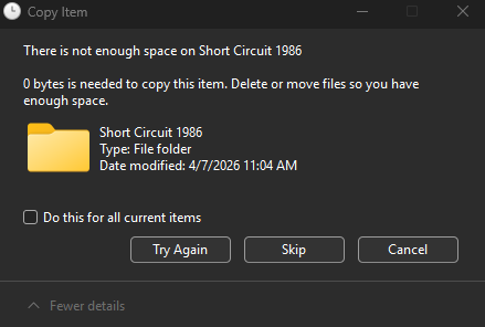

not enough space when upload file to share.
11 minutes ago, trurl said:
Correct. Be sure to only run it on that share.
i ran it on the share but when i tested a file its came up as needing 0 bytes to complete the file.

its gonna be a sub folder. so its gonna be media folder then either movies, shows, anime movies/ shows. its basically any of the sub folders.
Edited by Wolf223
So do you mean it doesn't matter which subfolder of the media share you try?

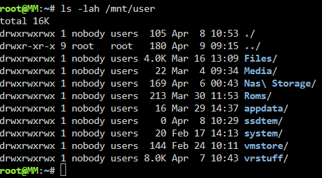

What do you get from command line with this?
ls -lah /mnt/user
ls -lah /mnt/user
i get the following

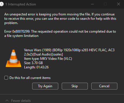

i ran bot new permissions and docker safe permissions. just to make sure it was not a docker container that changed the access. i was able to delete one file with out it throwing an error. but it still gives me space errors when i try to upload. it also threw up a new error on another file the other day. see attached
Edited by Wolf223
I don't see any errors on the Unraid side that would explain those. Do you have another client you could test with? It can be a phone or tablet.
