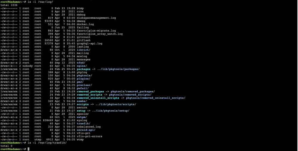

I just wanted to try an idea before I finished the installation of CrowdSec and added a port to Traefik. Well, it crashed. When I restarted it and began the continuation of the install of CrowdSec I just couldn’t get CrowdSecs GUI to connect. So I started to check logs and I realized that CrowdSec had lost the connection to the Traefik logs. Why? So I looked in static yaml, and for some unholy reason it had reverted back to the ”original” settings I had before I wanted to connect with CrowdSec. So I changed it back to:

And so I waited, patiently. No logs from Traefik. And for some reason I no longer had permission to edit the acquis.yaml in CrowdSec. So to make sure I uninstalled everything to do CrowdSec and restarted the server. Still no logs. Can there be a permission issue somewhere? I’m starting to wonder if I should remove the Traefik folder in /var log/ and create a new one. Unfortunately I’m not CLI user and I don’t use Linux commands unless I have the full string to copy and paste. And doing things in /var/log/ does make me nervous. If you think this would be a good idea to make a new folder for the Traefik logs I really would appreciate if you could help me with that. I attach a screenshot from when I ”ls -l” into /var/log/ if you can see anything wrong.
This is very confusing. Any idea or suggestion is highly appriciated.

The host path /var/log has nothing to do with those containers assuming the mappings you specified above.

traefik writes logs to /mnt/user/appdata/traefik/logs/ not the host's own /var/log/... You're looking in the wrong spot.
In fact, the containers have no access to /var/log since it isn't mapped. That's sort of the whole point of dockers, they can't get to anything you don't specify in the mappings.
You can examine the logs at the mapped host path
