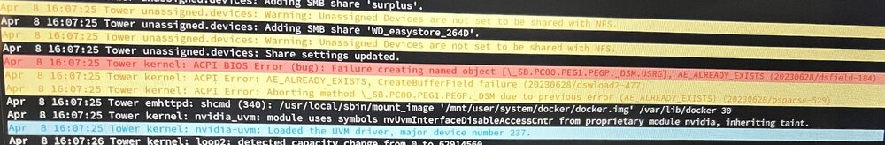

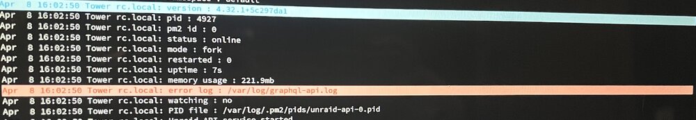

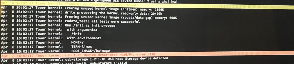

Sorry, didn’t grab the diagnostic initially. I just ran fsck on my usb, inserted it back into my tower, and now it boots. Plex along with everything else seems to be working again, but I still don’t know what happened. I still see some errors in my syslog. I’ve attached it along with diagnostic belowIMG_8289.jpegIMG_8289.jpegIMG_8289.jpegIMG_8286.jpeg

If it's working I guess it's OK. Not unusual to see some "error" lines on bootup as Unraid probes the hardware. The colors are completely based on keywords appearing in the line, such as "error".

Food for thought: If you continue to run into weird or inexplicable problems, it could be your usb drive (sda) going wonky. All sorts of strange can happen when they start failing.
