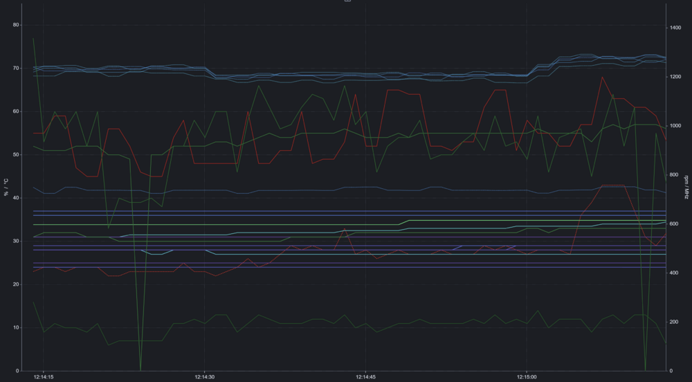

Then I came across CoolerControl... And WOW I have been super happy playing with that... I've got it so my system responds to heat in a reasonable way and I can see why it does what it does so that I can fine tune it further.
One thing I have been looking for is to bring the GPU Fan and Temps into the same ecosystem. I've looked around and found nothing that would work for that until...
CoolerControl can use a text file as a sensor
Nvidia has a couple of CLI tools that report data about the GPU
Gemini can write Python scripts...
So now I have a Python Script being started by Task Scheduler, A shared /tmp folder in Unraid, and a graph that shows me the Temperature info (and more: Fan Speed (%), GPU Load, Memory Load) in a graph with all the other relevant (and some irrelevant) data.
Now, while I can't control the fans on the GPU from here, I can have them and the GPU temp affect the Case Fans to expel extra heat when they start working overtime.
Some of the numbers are a bit weird because they are all interpreted as temperature so I have things displayed as percentages out of a hundred (labeled at degrees C)
Thought I would share in case anyone else wants this.
