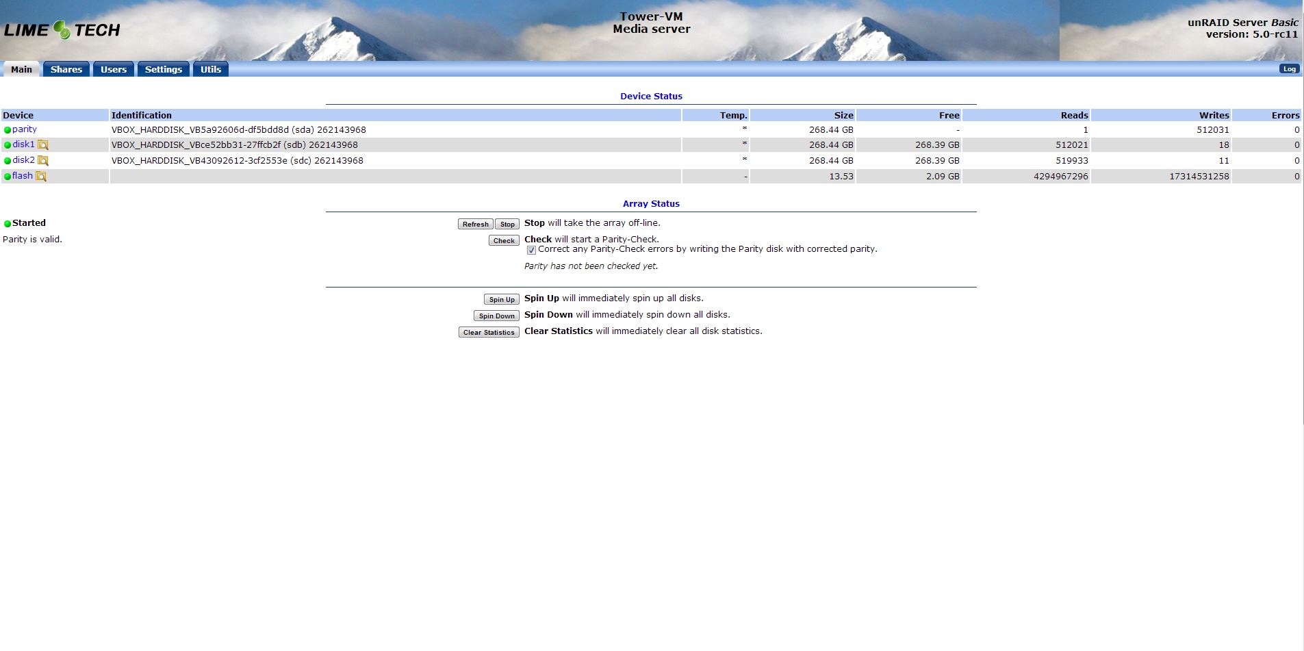

[*]Configure and format your storage.
[*]The Device Info. screen for your flash should show the GUID and registration info.

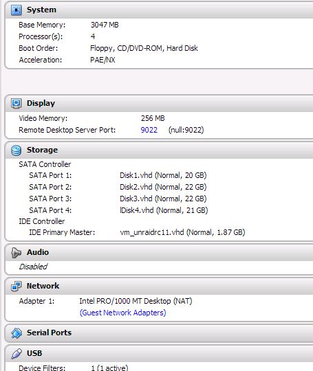

I have setup a new virtualbox machine like this:
I cant fire it up

I cannot see anything obviously wrong!
I have unRAID running without issue under VirtualBox and am not experiencing the issue you seem to have encountered.    My VM settings are shown on the attached screenshot.
The only differences I can see are that I have defined SATA disks instead of IDE, and that I am actually using a slightly different NIC for the bridged adaptor - but I would not have thought either of those should really matter.
You do not mention what version of unRAID you are intending to try?    If it is the new 6.2 beta which now includes a built-in GUI option then you can bring that up by editing the syslinux.cfg file on the boot device (I assume a VMDK) and moving the Default entry to the one to load the GUI. Editing the syslinux.cfg on the USB flash drive will not have the same effect (since VirtualBox does not supporting from USB then I assume you have this plugged in separately and passed through to the VM).  This is the same GUI that you would get by connecting from outside the VM via a browser.
