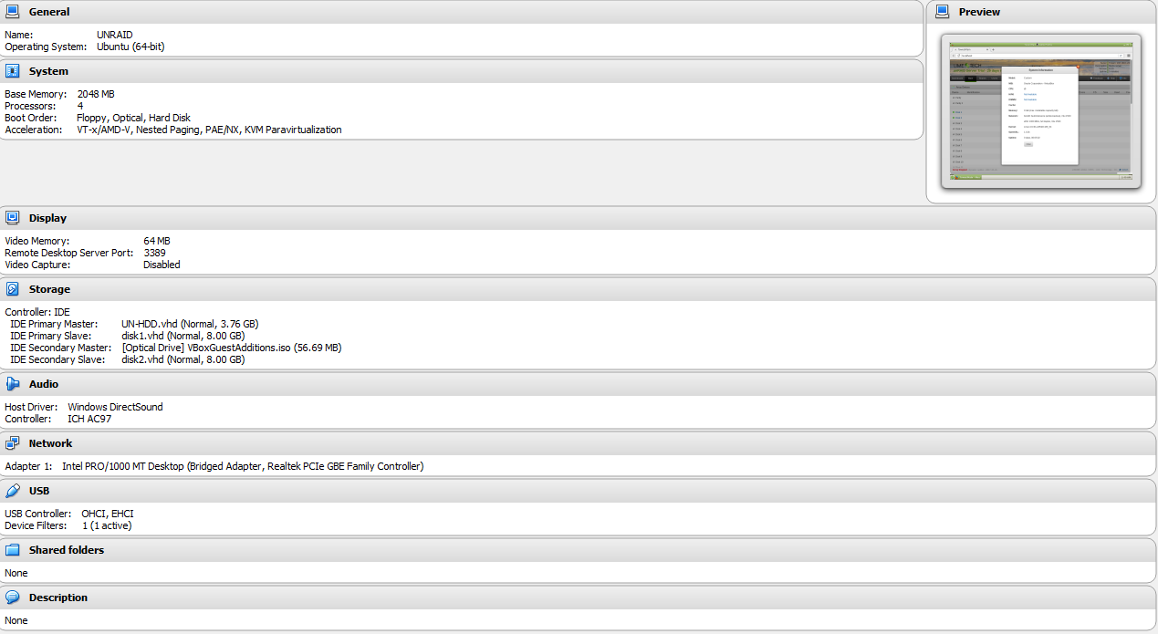

This is how I made it:
1 - Format USB memory with 2Tware Fat32Format 1.13 default values (windows didn't allow me to format a 64gb memory stick). After that tried with a 8GB memory stick but also formated with this program.
2 - Copied UNRAID 6.1.9 contents to that device (files and folders) and labeled UNRAID.
Executed make_bootable.bat as admin, a dos window is open and press key to continue... syslinux.exe -maf F:... Completed (if you don't name it UNRAID make_bootable doesn't work)
3 - Renamed USB memory stick to UNHDD before making image.
4 - Open Winimage 9 as admin. Select Disk / Use removable disk F: . Select Creating Virtual Hard Disk image from physical disk... Select disk, hit ok and named UNHDD.vhd - Wait 10 min
4.5 - Renamed USB memory stick back to UNRAID
5- Virtualbox:
  5.1: New
  5.2: Name: UNRAID_6.1.9
          Type: Linux
          Version: Other Linux (64bits)
  5.3: Memory size: 2048
  5.4: Hard disk: Use an existing virtual hard disk file / select UHDD.vhd
          (storage is on IDE Primary Master, tried SATA also)
  5.5: Network: Bridged adaptor (Intel® 82579LM Gigabit Network Connection)
          (I suppose is my "real" ethernet adapter)
          Advanced:
          Adapter Type: Intel PRO/1000 MT Desktop (82540EM)
          Promiscuous Mode: Deny
          Mac Address: xxxxxxxxxxxx
          Cable Connected: Yes
    5.6: USB:
          Enable USB Controller: Yes
          USB 1.1 (OHCI) Controller
          Add new USB filter with all fields initially set to empty strings
Start machine, blue screen with unraid options, load unraid, begin loading... but:
Now I have realized that there's an error and it doesn't find UNRAID: I tought those 30sec was the time searching for USB stick after started loading from HD USB image.
Does this give you any idea what I'm doing wrong?
Thankyou
Gus

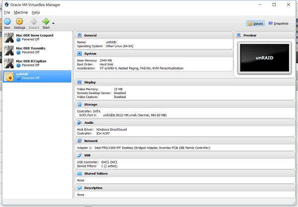

I have been able to boot and connect to unraid from virtualbox using this tutorial:
http://www.howtogeek.com/187721/how-to-boot-from-a-usb-drive-in-virtualbox/
but it doesn't pass a FLASH GUID and it's useless.

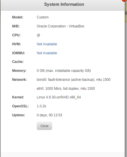

Guys,
I have everything working accept unRAID does not show HVM and Memory statistics. HVM states: Not available as Memory states 0 GB (max. installable capacity GB)
The Virtual Machine runs on Virtual Box 5.122r115126. I have got VT-X/AMD-V enabled. But as expected I am not able to launch any VM's inside unRAID because HVM is not available. Any ideas?
Thanks in advance!
Kind regards,
Danny
--- More information
VM Manager: Your hardware does not have Intel VT-x or AMD-V capability. This is required to create VMs in KVM. Click here to see the unRAID Wiki for more information
cat /proc/cpuinfo shows my Processor: Intel(R) Core(TM) -5-3470S CPU @ 2.90Ghz with flags hypervisor
http://ark.intel.com/products/68315/Intel-Core-i5-3470S-Processor-6M-Cache-up-to-3_60-GHz?q=i5-3470s
modprobe kvm_intel shows: modprobe: ERROR: could not insert 'kvm_intel': Operation not supported.
free -m shows: total 2005 used 249 free 1108.

... update, I got it installed, and got to a login prompt
For MAC:
Steps.
1. Erase USB, label it UNRAID
2 Copy contents of OS distro to USB
3. execute make bootable scripts (this needs the USB to be called UNRAID)
4. Insert USB into Windows machine with WinImage9 installed,
4.1 Select disk at the top, go down to make image from physical disk, select relevant USB and make image, calling it anything...
5. copy to folder where VirtualBox VM will be stored, rename to unread.vhd
