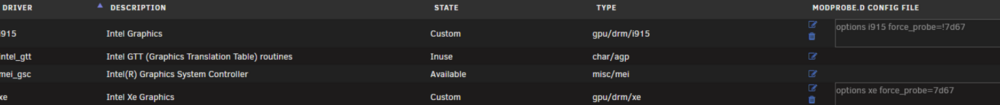

/dev/dri output:

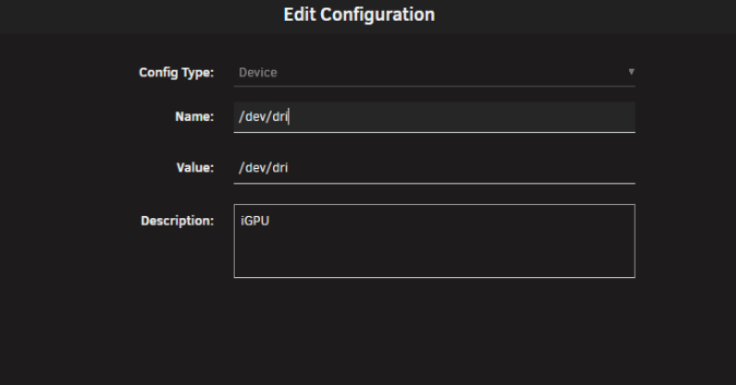

Plex docker device (I've also tried ---device /dev/dri under Extra Parameters ):

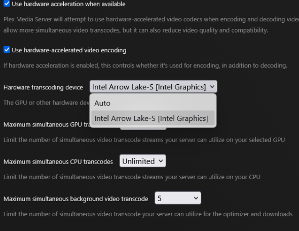

Plex transcode settings:
Forcing i915 ( I've also tried to force the XE driver instead )

Apr 15, 2026 00:45:55.419 [23074275515192] DEBUG - [Req#11c/Transcode] TPU: hardware transcoding: enabled, but no hardware decode accelerator found
