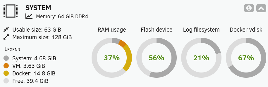

Today I received an alert with "Out Of Memory errors detected on your server". Anonymized Diagnostics are attached. System status appears OK. I haven't rebooted yet, as per @Squid recommendations. Any advice on what I should look at, and how to proceed? Thanks!

Back on APR 12 one of your containers (8c565a95c675) hit its assigned limit and was killed. Looks like a one-off occurrence so you can reboot to clear the log so FCP stops warning you. If it happens again, you can check the container's config or assign it more memory
Thank you @Michael_P With the help of ChatGPT, I traced it back to my Calibre-LAN container. It appears it blew through the default 4GB setting during some conversions I was running. I upped the memory allocation to 6GB and am rebooting the system.
