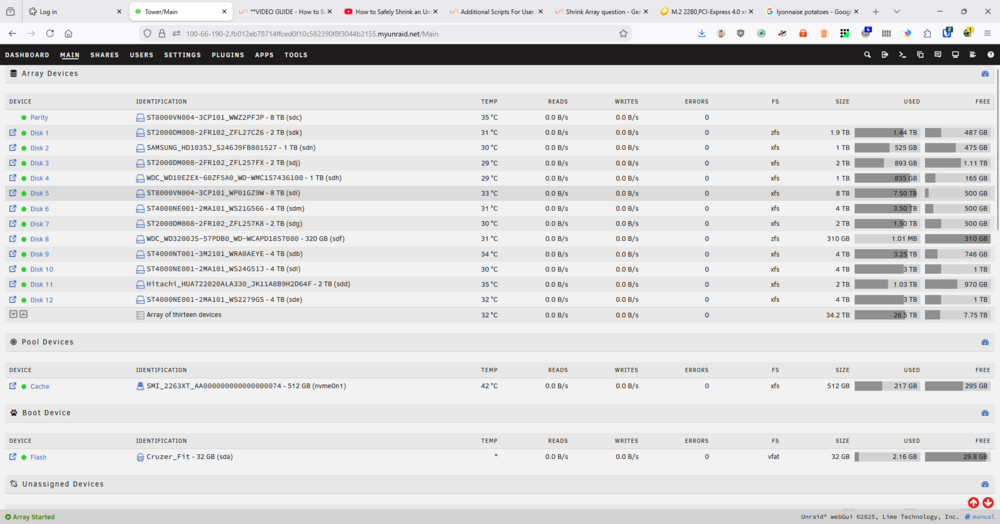

I am unable to start my array.
On the Main Tab, the start button is greyed out. Best the grey start button, "Too many and/or missing disks!"
Before performing the following, I took a screenshot of the array. See attached.
This issue arose shortly after I thought I had successfully shrunk my array by removing a 380GB HDD. Dev 1 WDC_WD3200JS-57PDB0_WD-WCAPD1857080 (sde)

I think the drives might be assigned incorrectly. How can I look where the system is expecting the drives to be?
Thanks
