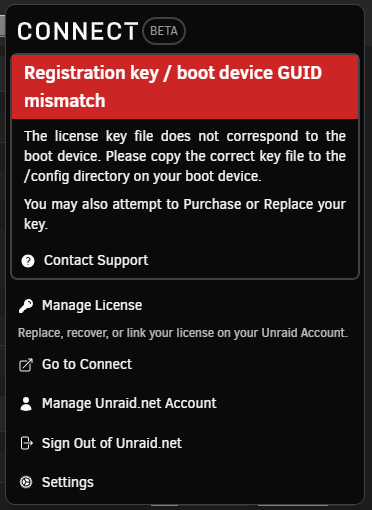

All of a sudden I get this:
and my fans spin up as my array goes offline...
WTH?
Anyone have any thoughts before I reboot my server?
jupiter-diagnostics-20260421-1429.zip
Solved by Arbadacarba
OK, Tried a reboot and got a bigger version of the image above...
I wonder? Pulled the USB Drive I had plugged in... and System is back...
Dangit... that is an unraid thumb drive that I created for something...
