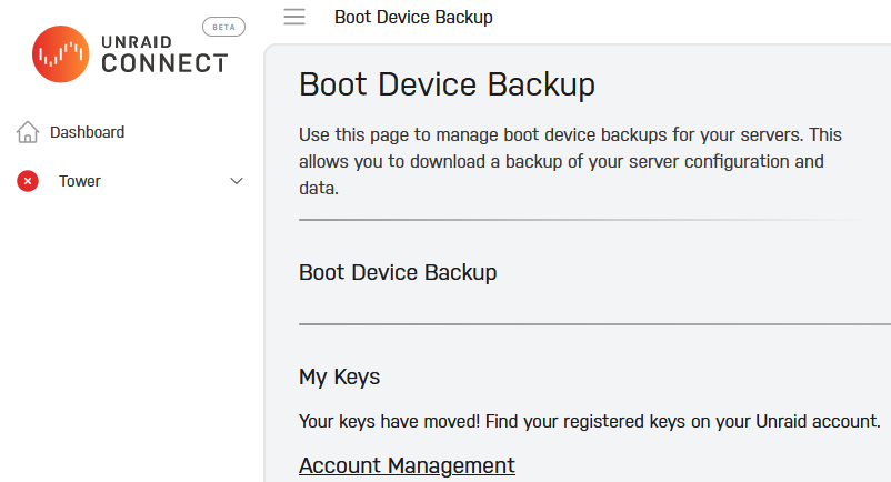

In the past I have setup USB backup via Unraid Connect.
The issue is that when I login to Unraid Connect I am not able to download a backup of my bootable USB, that option is simply not there.
I have raised a ticket with support but they have not been able to help me.
What am I doing wrong? Shouldn't my backup be available, despite the fact that the server is offline?
