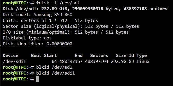

Do you know which file system was the pool?
Also post the output from
fdisk -l /dev/sdi
and
blkid /dev/sdi1

Here are the outputs from the commands requested:
blkid /dev/sdi1 did not output anything

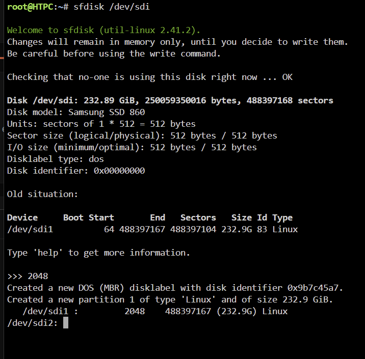

There are currently no partitions. Type sfdisk /dev/sdi, then type 2048 and hit enter and post the results, without typing anything else for now.
Ok, thank you very much for the guidance!
I typed sfdisk /dev/sdi then 2048. Here is the output:

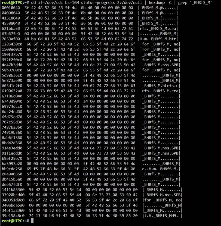

Sorry, I'm not sure how, but I missed that the device does have a partition, but the partition doesn't have a btrfs signature. Hit CTRL + C to abort (that command doesn't create the partition on the actual device before it's written, so nothing was changed), and then type instead:
dd if=/dev/sdi bs=16M status=progress 2>/dev/null | hexdump -C | grep '_BHRfS_M'
If there's any output after you get the cursor back, post that, It will take a few minutes.
@JorgeB I ran the command above. It started running, printing a new line every couple of minutes. Unfortunately, when I came back, a few minutes later, the terminal window had closed by itself (which has happened a few times before).

Here is the full output from running the command you requested:
That lines up correctly with a btrfs filesystem on sector 64, which is the current partition starting sector, suggesting the main superblock at least is damaged, becuase no fs is bound
Let's see if it can be recovered from the backup superblock, post the output from:
btrfs-select-super -s 1 /dev/sdi1

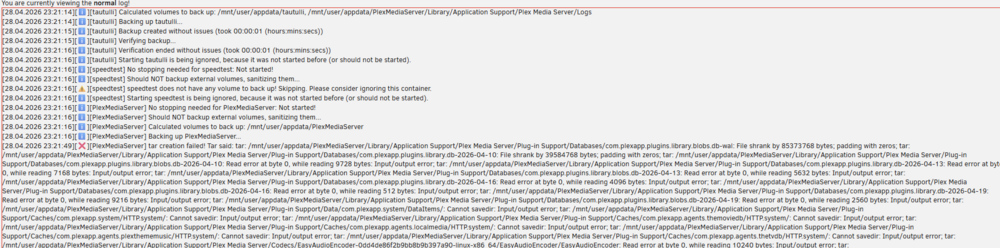

I decided that before I dig the hole deeper and mess something up even more, I took your advice to install the Appdata Backup plugin and tried to manually run it. The backup failed twice, where a couple of dockers' appdata did get backed up successfully, but several other important dockers failed. The log shows walls of tar errors, like this:
