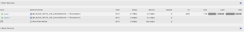

Strange about the cache, it may have been full quite awhile ago, but hasn't been full for several days (see screenshot attached).
The NVME error is something ongoing that I simply ignore:https://forums.unraid.net/topic/118286-nvme-drives-throwing-errors-filling-logs-instantly-how-to-resolve/
I beleive the issue is more Firefox related, as closing it out and restarting tends to solve. I discovered this today. Strange things is that none of the other containers ever exhibit this behavior. Only Lidarr and SABnzbd
