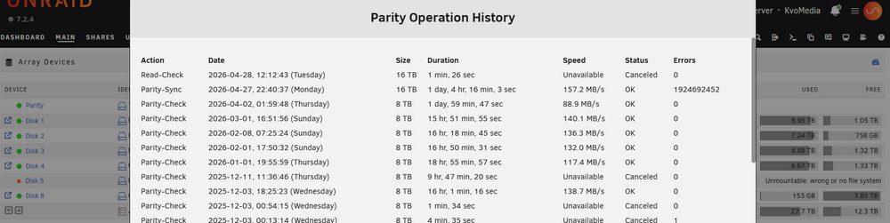

I was updating my parity drive to a larger size. when it finished the parity check my disc 5 started to have issues and says unmountable.
since the check on 4-27 says the status is ok and I want to change all my drive to a larger size I am wondering if I can just replace the disc 5 with a new larger drive and be able to rebuilt it with the parity?
I am assuming the answer is no with the huge number of errors but not sure why it would show the status as OK if the parity was not intact

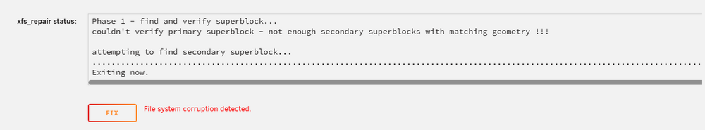

tried to fix it twice but this was the result both times. what should i do?
That means the file system is very corrupt; possibly parity is not 100% in sync. See if the actual disk mounts with the UD plugin; you can do that after unassigning it.
