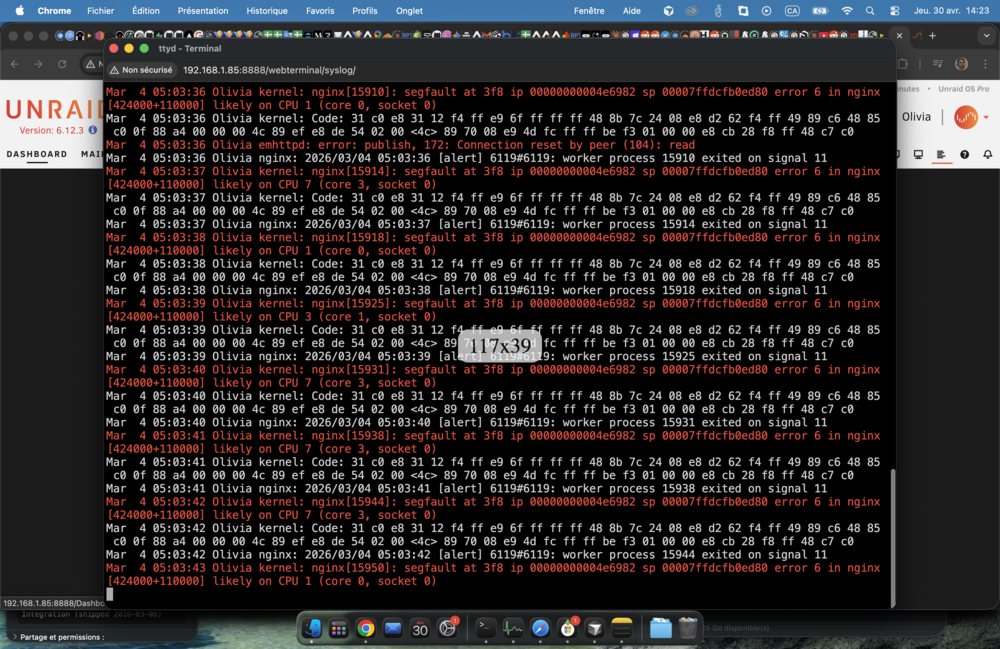

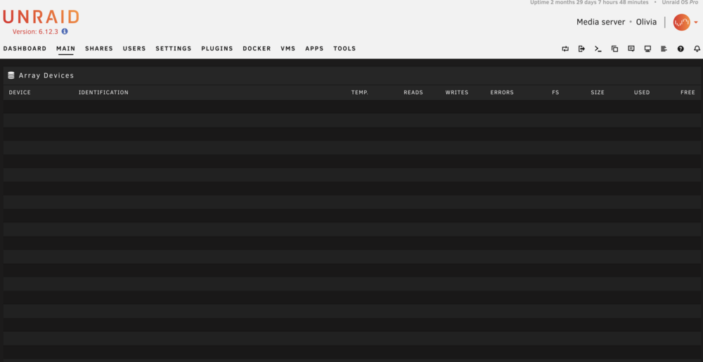

It a bit trivial but its something happening for months, after a certain time the GUI become broken. It fails loading data only showing an empty gui, some part of the gui are shown but not everything. I can see buttons or details (as seen on attached screenshot) but I can't do anything, page are sometimes not loading showing an Empty Response error. I can't even properly reboot to get it I have to deal with unclean shutdown on a regular basis. I have no exotic plugins its pretty the same configuration and the same docker images running for a while, all services are running fine so it's pretty a silent failure. It starts failing last year when I was abroad, this time i'm at home and I have been able to capture the log by screenshot very fast because the popup is closing itself. I'm quite sure it certainly be part of the issue.
