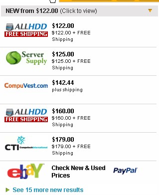

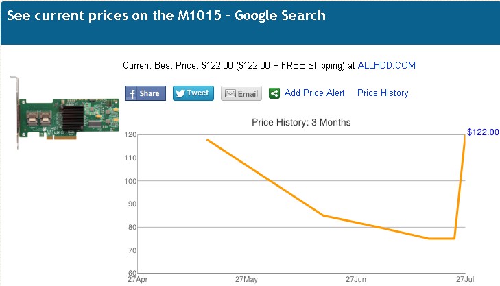

Where are you guys finding M1015s so cheap?  The SuperMicro AOC-SAS2LP-MV8 is $120CAD e-tail whereas the cheapest m1015 I've seen on ebay is $135 and the warranty situation is questionable.
Hi all, here in the UK these controllers are priced identically. Seeing the recent LSI controller troubles, i don't see why anyone would go for the M1015, especially since the SM can do 6GBPS as well?
