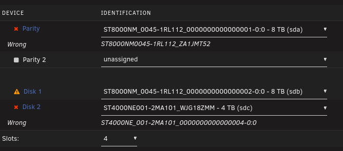

Rebooted just now and Disk 2 is again showing errors. For some reason Disk 1is also spun down and won't spin up.

Did you shutdown or try to fix it "hot"?
Shutown, unplug DAS from PC and unplug both from power before trying again.
OK. Shutdown, DAS and PC powered off and disconnected from each other. Everything plugged back in and powered back up.
It is very upset.
USB is the reason it can't identify the drives. The USB interface is adding characters to the serial.
And USB is probably the reason for the read errors we were having on disk2 earlier.
You will have to New Config everything again. This time, in addition to checking the Parity Valid box, also check the Maintenance mode box. Then start the array. That will get all drives accepted again without altering any of them in any way since they won't be mounted in Maintenance mode.
Then you can stop the array, unassign disk1.
Then start the array with nothing assigned as disk1. Might as well start in Maintenance mode so no drives will be changed. That will disable disk1 again so we can try rebuild again. We won't be able to see if emulated disk1 is mountable in Maintenance mode, but at this point that would be the least of our concerns.
Then stop the array, reassign disk1, start the array to try rebuild again. If there are any errors in the ERRORS column for any drive post new diagnostics.

OK, I've followed the steps you gave and it's started rebuilding again.
