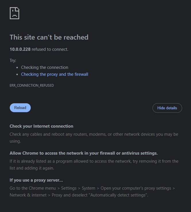

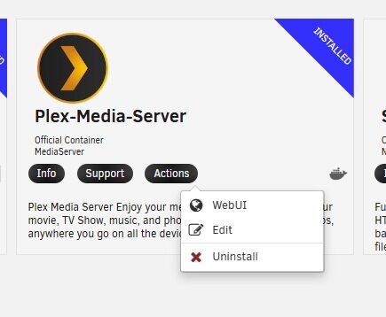

Then I navigated to Apps, Installed Apps, and under Plex I selected Web GUI and got this error:

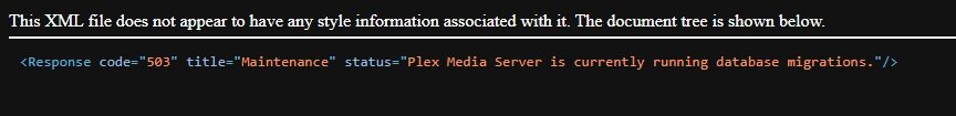

So I keep trying to access my Plex Server via the Web GUI and once (only once) I got this message:

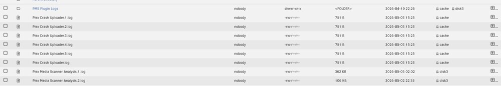

Odd? So I went looking at the Plex logs and found this information suggesting the Plex Database is corrupted?
Opening 2 database sessions to library (com.plexapp.plugins.library.blobs), SQLite 3.39.4, threadsafe=1May 03, 2026 15:34:41.667 [22679620614800] INFO - Running migrations. (EPG 0)May 03, 2026 15:34:41.667 [22679620614800] DEBUG - Captured session 0.May 03, 2026 15:34:41.667 [22679620614800] DEBUG - Captured session 1.May 03, 2026 15:34:41.698 [22679620614800] ERROR - SQLITE3:0x80000001, 11, database corruption at line 72267 of [a29f994989]May 03, 2026 15:34:41.698 [22679620614800] ERROR - SQLITE3:0x80000001, 11, statement aborts at 51: [INSERT INTO metadata_agent_providers (identifier,title,uri,agent_type,metadata_types,online,created_at,updated_at,extra_data) VALUES (:U1,:U2,:U3,:U4,:U5,:U6,:U7,:U8,:U9)] database disk image is malformedMay 03, 2026 15:34:41.698 [22679620614800] ERROR - Error: Unable to set up server: std::exception (N2DB9ExceptionE)May 03, 2026 15:34:41.698 [22679620614800] DEBUG - [JobRunner] Job running: /usr/lib/plexmediaserver/CrashUploader --sessionStatus=abnormal --sessionStart=1777847681 --sessionDuration=0 --version=1.43.1.10611-1e34174b1 --[email protected] --sentryUrl=https://o17675.ingest.sentry.io/api/1233455/ --sentryKey=xxxxxxxxxxxxxxxxxxxxxxxxxxxxxxxxMay 03, 2026 15:34:41.698 [22679620614800] DEBUG - [JobRunner] Jobs: Starting child process with pid 16013
