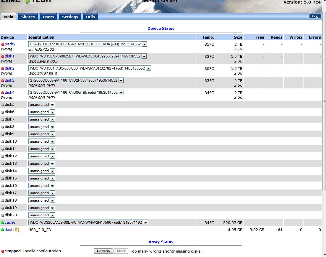

Followed upgrade instructions on main rc4 download page.
Started with 5.0-rc4, no drives assigned.  Manually assigned drives correctly (see attached), but too many 'wrong' drives.
Did not change hardware, anything.  Removed all customizations from go before starting.  Re-checked and rebooted, same results as screenshot.

The situation is a little confusing, because your pic shows 5 drives still assigned (although badly corrupted), but you said that you "started with 5.0-rc4, no drives assigned".  When it started, did it appear to have no drives assigned?  I believe that normally, when converting from v4 and starting v5, the drive assignments should come across still intact, and all you should have to do is verify each drive, make sure each is assigned correctly and the MBR's show correct alignment.

The pic shows the 5 drives assigned after I manually assigned them, per the previous list I saved.  To me, it looked like 5.0 did not see the drives the same as 4.7, but I was lost at that point and did not want to risk losing my array.
I should have explained better, that the 5 'Wrong's showing in your pic shows that 5 drives were assigned, otherwise it would not know that your new assignments were 'Wrong' (did not match the previous assignments).  If there had been nothing assigned, then nothing could be wrong with the new assignments.
It looks to me as if there was a 4 byte data slide, data being offset by 4 bytes from where it should be.  Your 4.7 disk.cfg and super.dat (in just a quick look) appear to be fine.  So as Joe says, using the New Config should bring you back up.  I was afraid they were corrupted.  Just make sure you check all disk settings, both for the individual disks and the general spin delay and spin group settings.
